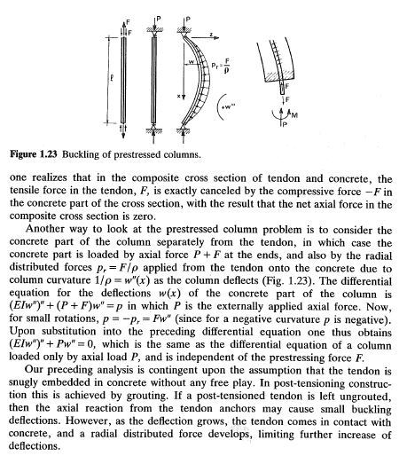

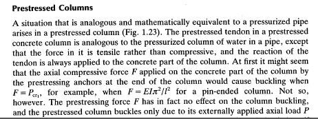

Here is an excerpt from Bazant's exellent book Stability of Structures. It deals with precisely this question. If you figure out why the piles are restrained prior to cutting, please do report back.
Thank you very much, it was an excellent, very to the point answer.
