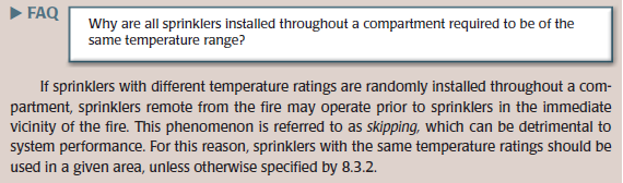

The other issue is the sprinkler's RTI. Mixing of QR with SR sprinklers increases the potential of sprinkler skipping, resulting in an excessive number of sprinklers operating. This is more problematic if QR sprinklers were used to reduce the sprinkler design area.

Temperature ratings of a sprinkler are used for the following; A) To keep sprinklers from operating accidentally if installed in a high ambient temperature area & B) to control the number of sprinklers operating in the design area.
--Since different temperature rating of sprinkler is installed within the same space, there is a possibility that the sprinklers will not actuate as per it was intended to in which it will contradicts the intention per the above (B).

Contractor could say that NFPA doesn't prohibit him to do so as you said, but installing same type of sprinkler is also as per NFPA.
Therefore, owner could insist the same and the contractor should follow.

Fully agree with SprinklerDesigner2, check their approvals from AHJ and their submitted shop drawings and if they do not show the varied sprinkler temps that were installed, request they follow the documents.
