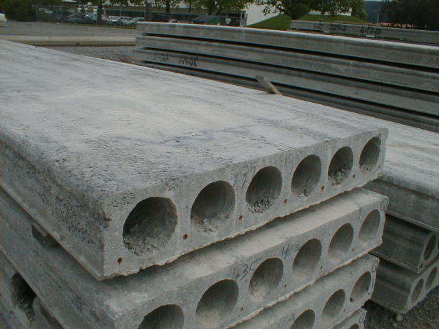

But, how would you be assured of avoiding that even in precast plank?
1) use anchors shallow enough that it doesn't matter.
2) fasten to the flange where there should be no prestressing.
3) Have reinforcement scans performed to locate conflicts.

Getting anything into the vertical stem of the tee's without scanning to find gaps between strands will be hard. Even then I'd avoid going into the bottom of the stems at all costs. You may find room on the sides of the stem but I'd only use this as a last resort.
Going into the flanges will be much easier and I'd go that route. Should have a lot less rebar as well. As it's an existing structure I'd scan a section of it and try to establish what the rebar spacing is in the flanges. You should then be able to locate your pipe/conduit hanger center to center spacing so that you don't hit any bars. If you do hit a bar then I'd just patch the hole with a repair mortar like SikaTop 123 PLUS and relocate the support to miss.
