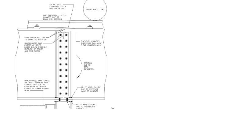

As seen from the attached photos (pic-1 and pic-3) some of the crane runway beam bolts ruptured and runway beam bottom side moved.
This problem occur only in one beam connection and same connection detail used along the facility.
I need to find out the reasons behind this problem and since yesterday I found several alternative reasons as I mentioned below;
- fatigue. (but i don't why only this one not the others.)
- some bolt clearances of 'this' produced plate is different from the attached detail and so several bolts worked alone for runway beam dynamic loads.
- lateral torsional buckling has occurred and lateral force at bottom flange ruptured the bolts.
Any reasons else?
Thanks,
Dogan.

It is not a good design per the circled connection in the pdf file. The configuration restraints the crane beam end from rotating, and therefore the bolts or the crane beam will experience fatigue damage. Of course, it also depends on the crane work class. The connection may be not critical for light work class crane. And there is no lateral supports on the top flange of crane beam ends. For your information: “Crane-supporting steel structures - design guides” gives some example how to setup the crane connection.

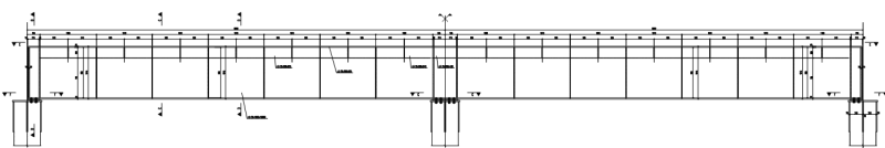

I notice from your PDF drawing that the crane girder is made up of 2-spans @ 8m each, continuous spans.
With continuous crane girders it may be possible that your end-span connection bolt failures are due to tension forces when the crane is in the opposing/adjacent span, causing fatigue effects in the connection.
To troubleshoot the probable-cause it may be worthwhile to up-close visually observe the end-connection when the far-span of the crane girder is traversing under load.
