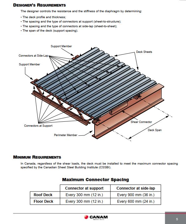

In the below image, imagine the steel beam aligns with the end of the roof deck. Do I need to provide a continuous angle, welded to the top of each joist, such to attach the metal deck to?

Also, I believe the Steel Joist Institute calls for it to be attached to the joists at a maximum of 18" o.c. (the metal deck).
See also Simple Connections Simplified, Holtermann, Martin, Steel Joist Institute, May 16, 2018, Slide 31-.
The attached comes from the Canam Deck Catalog. A diaphragm needs a continuous chord to resist wl^2/8b where b is the width of diaphragm. It may not be framed exactly as shown in the diagram, but maximum connector spacing in the table should be followed.
