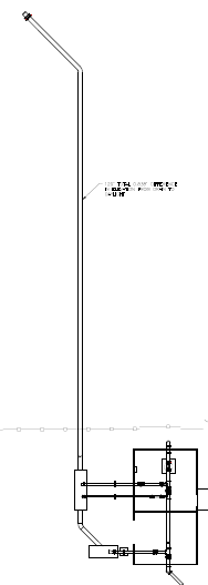

Hello!
I have a concrete box that is going to be filled with water at 900 gpm, the dimensions are 7' * 5' and a 3' depth. I am planning on installing a 12" drain pipe made of PVC coming from the side of the concrete box, it daylights 120 ft out with only a .838 ft drop (about 10 inches). Will this be able to satisfy the 900 gpm demand without overflowing the concrete box? I used the haze williams equation to find that the 12" inch drain should discharge about 1992 gpm, which would definitely satisfy the 900 gpm demand. If this is wrong in anyway, or have information for a solution, please enlighten me!
Thank you!

This needs a sketch to show sheet this pipe is in the tank.

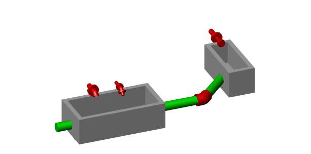

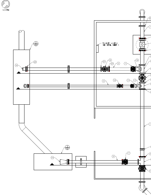

Here is a little draft I came up with for what I am thinking of. The inverts of both 12" pipes are at the bottom of both basins, water would only be going into one basin or the other not at the same time with a 2.4 inch drop between the connections. I changed the one I was talking about before (the left box) to be a 10' length * 5' width* 5' depth. and the right box to be the original volume of 7' * 5' * 3'. Daylight has been changed to a different position where we get a 1' drop over 120 ft after changing the main box to a 5' depth.

I think we got a little off track, I was originally creating a basin with 12" drain coming from the bottom side of the basin, it comes straight out with a constant slope of 10 inches over 120 ft. This basin would have 900 gpm flowing into it from around anywhere from 5 min to an hour. I believe that 12" drain pipe at that slope is good enough for that demand. This box would be for the two pipes on the left that shoot out into the box from a foot high to act as a backflow preventer through means of an air gap.
The most recent post I made was after I made a revision to add a second sump box for the singular pipe outflowing 900 gpm into the box on the right that leads to the original box on the left at a lower elevation. I made the original box larger and deeper to give a little more headroom and to make sure the elevation of the original box is lower than the added box. The added box also has a 12" drain that will lead to the original box and drain from there. Having the added box also will give me more volume in case something goes wrong and the 12" drain is not discharging as expected. Having a deeper box gives me up to 4' of water depth for pressure and still leaving me with a foot of depth in the basin to be safe. I also plan to daylight somewhere else that will give a 1 foot slope over the 120 ft distance.
I was asking on advice for if my assumptions of the 12" drain capabilities were correct or not and if that would lead to needing a larger box size.
A flow rate of 900 gpm is 2 cubic ft per second. If the cross section of the box is 5' wide x 4' deep that is 20 ft2. The velocity across the box will be 0.1 ft/second. I cannot see this causing hydraulic jumps or serious aeration. It look like a reasonable design to me.
