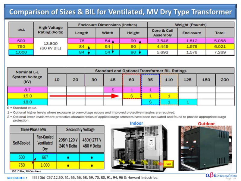

IEEE C57.12.01 is where I noticed that 13.8kV (15kV class) transformers are allowed to have a BIL of 60kV / 95kV / 110kV.
The options are limited to gain space for a 750 kVA, 13.8 kV/600V class standard dry-type transformers.
Small improvement could be obtained if reduced the capacity to 500 kVA with fans cooled to obtain up to 667 kVA with lower BIL relying on surge arrester for surge protection.
Although feasible, the risk/size-reduction of ~6" in lend is hard to justify. (your call).
A suggested alternative is to explore with an outdoor unit with a NEMA 3R enclosure to be located in the vicinity of the e-room.
Check also with a couple of transformer manufacturer to search for a non-standard application using cast-coil with a custom made enclosure.
The sketch below provides a brief illustration. Hope this help
