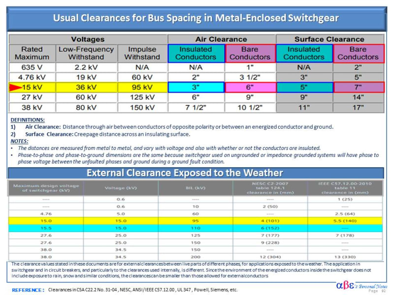

Thanks Cuky2000. What is industry standard phase-phase and Phase-Ground electrical clearances for 13.8 kV nominal system voltage? I am thinking NESC but I am in Canada and am looking what CSA standard would that be.
Or I would be relying on the switchgear measurements between bus terminals.
Regards,
Most of the industry-standards alow the manufacturer freedom to choose values appropriate to the product design and manufacturing process including the bus clearance provided that the product must pass the design (type) tests in the respective standards associated with the impulse withstand (BIL) and power frequency withstand.
The clearances per NESC and IEEE C57.12.00 are applicable to the external live parts exposed to the weather. Below is a chart with usual values used in the industry for bus clearance for MV switchgear inside the enclosure and external clearances per the NESC and IEEE Std for reference.
Since testing the switchgear and cable is not a practical option, check if is possible to insulate the portion of the bare connectors with insulation at least the same or larger than the switchgear bus insulator.
NOTE: The dielectric performance of the equipment is affected by a great many factors, including distance between conductors, and to the enclosure, shape of the conductors and adjacent conductive elements including those of the enclosure Insulation, if any, on the conductors Atmospheric conditions, including atmospheric pressure and humidity cleanliness of the equipment and aging of insulation.
