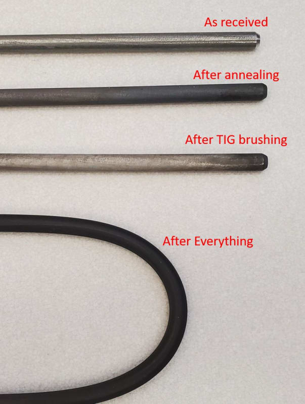

Thanks so much for your reply! The forming is not that aggressive and is in a localized area. Unfortunately we did not check hardness after the 1400F step. As far as the atmosphere . . . um . . . well . . . let's say it's rather nitrogen rich at around 78% . . .

You will have to acid pickle off the outer layer of oxide and damaged metal under it.
The surface will be low hardness.
You need to either grind into the base metal for a test or pull a full section tensile.
For a part this small wrap it in HT foil to minimize oxidation at the high temps (1950 and 1400).
It is easy enough to make a pouch that you can open quickly for cooling.
Soft almost indicated that austenite was not trnaformed to martensite. 1400+cool is more likely an issue than other processes.
N2 atmosphere could impact from two perspectives:
1. N stabilizes austenite to prevent martensite transfer.
2. N prevents NiAl precipitation, especailly on the surface of the material. Even if NiAl is precipitated, due to large lattice parameter difference between austenite and NiAl (need fcc ferrite or fct martensite to match NiAl), there is no coherent effect, so no hardening effect.
Air usually isn't that big of a deal.
The oxidation blocks most N uptake.
A nice clean N+H atmosphere is a disaster, because of what Ben said.

We reviewed the feedback from above internally and it turns out that our HTer did enclose the rods in foil pouches during both the initial anneal at 1950F and the austenite conditioning at 1400F. Additionally, he also added a certain paper to remove the oxygen in the pouch. We're pretty sure the material properties were unchanged to the core as I was able to bend a "TH 1050" rod into a U shape with my hands. Certainly can't do that with Condition C and certainly wasn't expecting to be able to with TH 1050. Posting a picture below of how things look throughout the process.
At this point, I think our plan is to pickle the parts and give it another go. I'll certainly post the results.
