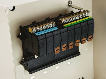

Mbrooke; Thanks for the UK panel vid. Seems pretty clever. I like that it could all be on one DIN rail. I'd have lots of fun with that!
The one thing that was horrid was the busbar game. Yack! It looks like you have to remove the bus bar from everything to change one breaker. The buss bars are also under there to light-you-up if you forget. Seems it would be dangerous even to work on just 'one half' since the other busbar is still there waiting for its opportunity.
NEC domestic panels are always worked on hot with single circuit work not blacking-out any other circuits.
Keith Cress
kcress -
It's possible to swap a breaker without removing the busbar. The observations about live working are on point though - I don't work on domestic very often, but I switch it off on the occasions when I do. Schneider's 'Acti 9 ' range of boards has a sliding isolation link for each outgoing pole - it's a good system and makes for a relatively safe board to work in. In the image below the brown tabs slide down when the MCB is fitted and connect it to the bus. When the tabs are in the position shown the outgoing stabs are dead.

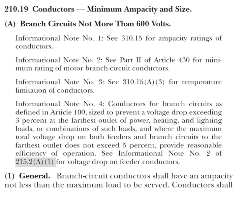

Mbrooke said:
but the larger sizes will not stop someone from running 2000 feet of #12 UF to a shed. A simple table of max lengths for a given voltage with ungrounded and grounding conductor combinations would suffice either way.
That would be rule 8-102 Voltage drop (see Appendices B and D)
(1) The voltage drop in an installation shall be based on the connected load of the feeder or branch circuit if
known; otherwise it shall be based on 80% of the rating of the overload or overcurrent device protecting
the branch circuit or feeder, and not exceed
(a) 3% in a feeder or branch circuit; and
(b) 5% from the supply side of the consumer’s service (or equivalent) to the point of utilization.
The simple tables are table D3 for 120 Volts AC and above.
Table D3
Distance to centre of distribution for a 1% drop in voltage on
nominal 120 V, 2-conductor copper circuits
This is a simple table. You simply extrapolate for other percentages and other voltages.

Regarding voltage drop, yes it is mandatory in the CEC. And with table 68 in the 2015 CEC you now have an explicit limit on length of dwelling circuits. However in the NEC voltage drop is only a FPN and there are no loop fault impedance requirements either.
From the 2017 NEC:
