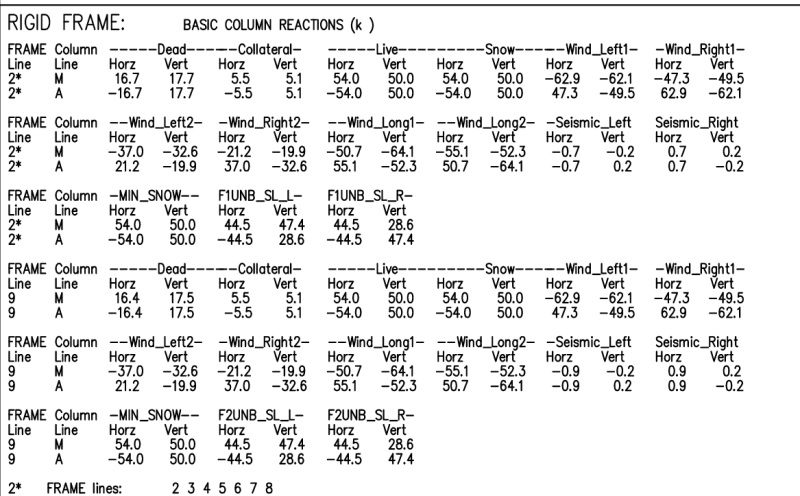

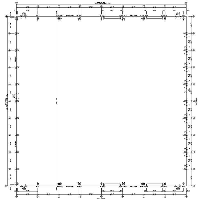

Here is the layout and reactions of the PEMB
and the loading will be from telehandler. unladen wt = 67000lbs with a lifting capacity of 28000 lb

I will say that the detail you posted in that image is laughably inadequate for most MBS foundations, even small ones, unless you have a lot of additional detailing shown elsewhere.

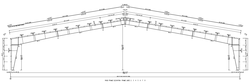

I hate the outputs of these PEMB programs. Very hard to follow and there is not enough diagrams. They only show diagram one axis only. Took me a while to figure the lateral load of the end walls (Column at line 1 and 9). Good luck to you! Also you have pretty big horizontal reactions from snow and dead load! On all of the PEMBs I have done, I only get large horizontal reactions from wind. What does this thing look like elevation wise?? The columns are tilted?

@Doublestud the elevation is here

Now to your design. I input some of those loads into a spreadsheet I have and not knowing more information about your foundation, ie thickness and how deep you have it, I cannot offer an opion other than your 9' square footing is very inadequate if this is a turndown footing and not centered under the column and buried at least 3' deep to top of footing. Uplift only, not including any increase for prelim loading I am larger than a 9' square x 24" thick at a depth to top of 3' assuming 110 soil density and accounting of a 0.6 factor in resisting dead load (including foundation weight) while including a triangular soil area above as resisting weight based on depth to top of footing. I also didn't look to see if there are braced frames along that line that may impact foundation design. That being said, if you are using an offset footing with this kind of loading, I suspect you will be a factor of 4 min times larger than a foundation centered under the column due to overturning moment induced, even with uplift loading. Based on your horizontal reactions, you will most likely need tie beams. If this were my project, I would have spread foundations, pedestals top top of slab and tie beams and wouldn't even try another system for something this large (other than maybe caissons if the geotech recommended them).
yeah, that gravity loads put a lot of thrust! Definitely cannot rely on slab and hairpin. I have never done one this span before. Your horizontal outward forces are huge! Good luck.

Correct, I would have tie beams across the whole building. with PEMB and probably a thin slab, no I don't think there is enough weight to resist that kind of thrust loading. remember this thrust occurs at 25' o.c., so you have a 25' long strip of concrete by say 5" thick x 250' long which is 390.6 kips weight, now apply 0.6 factor and a 0.35 friction coefficient and you can resist 82 kips thrust, but you have thrust each end in opposite directions, so if not tieing teogether with a tie beam you get half each side, so 41 kips resistance. This doesn't even cover thrust from the live load alone.
