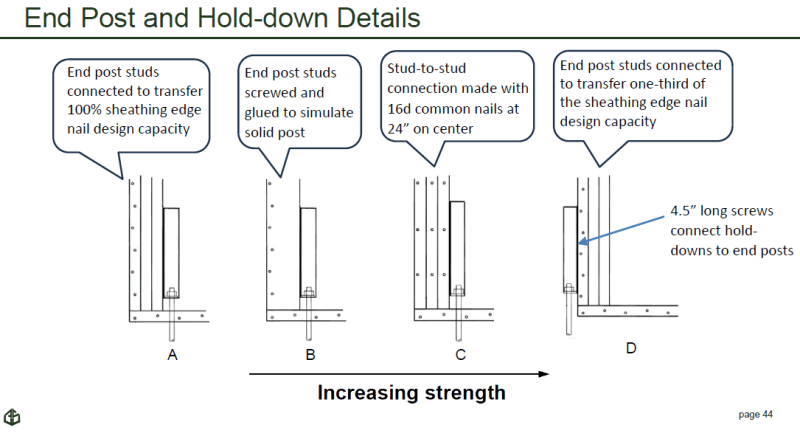

Deker beat me to it, your capacities are essentially the same, just new nominal values for reporting in the tables. However, yes, we are taking adjustments for the eccentric hold downs if located on the inside of stud pack in 2021 SDPWS (don't worry, that will very likely change or be eliminated in the next code cycle, we are working on submittal and revisions for committee review, it will simply require a change in how sheathing is nailed to boundary stud pack, but you are still stuck with it for a 6 year code cycle). I think AWC and Phil Line had a webinar a couple months ago that discussed, maybe there is a recording out there, I can find the name if you're curious.

One meaningful difference that I came across between SDPWS 2021 and 2015 is in Footnote 10 of Table 4.3A which applies a 0.92 multiplier for shear walls with 10d nails with "...hold-down attached to the inside face of the end post..."

Yeah. The 0.92 was what I was referring to by the 8% reduction. I just completely misread 4.1.4 when I pulled it up. The result was my quasi-rant of a post...
ChoarsDen - I'm all for more learnin'. I was watching the webinar on short vs long nails in shear walls based on the 2021 SDPWS which is what clued me into it initially. They were saying this is based on cyclic load tests. I'm curious - did this not show up in the old data? Or was it overlooked?

Yep, that's the one I was referencing, the one presented by Phil Line in Sept 2023. Believe it was titled "Wood-Frame SHear Walls & SPWDS". Slide 44 is the section I am referencing that is in committee to modify the 0.92 adjustment in the next SDPWS, I'll include a photo below. Testing indicates assembly type C & D provide sufficient strength to eliminate the 0.92 adjustment, just needs to be approved by committee.

That I cannot say, all that testing was before my time, and I do not have direct access to that particular historic test data. I could ask some associates, but not sure what benefit such info would provide to us practicing today.
