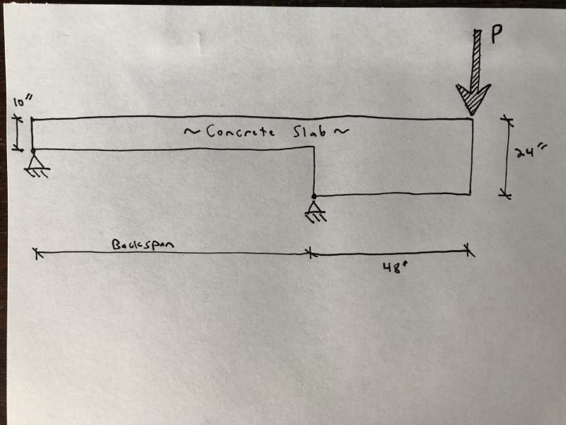

Currently designing a custom home with a 23.1k (15.4D / 7.7L) loaded column at the edge of a 4'-0" max cantilevered slab with 10" backspan thickness, and 24" cantilevered thickness. The 24" cantilevered thickness can be used at the column but will be furred to depth elsewhere to reduce weight. Do my structural engineering friends have any pointers or areas of concern that I should calc for? I was going to design a cantilevered concrete beam to pick up the column load and transition to a grade beam at the back span. Is this a bad idea or are there better ideas for this situation?

Seems sketch AF to me. Since you max moment will be at the 10"/24" interface, I am not sure how the 24" depth is helping you.
Maybe post some sketches (no pun intended!)
I'm all for discreet load paths...give it a clearly defined beam with a constant depth through its length. I hope you know what you're doing...those loads are pretty extreme for single family residential. If the contractor even thinks about ignoring your drawings (as so many residential contractors do), somebody could easily get hurt.
I'm not sure what your question is. If I'm to guess that your intention may be to design something like in the following sketch, this seems like a very bad idea.
If this is your intention, you might as well just design the whole thing as 10" thick (which I will guess has zero chance of possibly working). There is no point in having a deep cantilevered span transition sharply to a shallow backspan. Maybe gradually tapering back could work.
A detail and/or additional explanation on your part would be beneficial.
