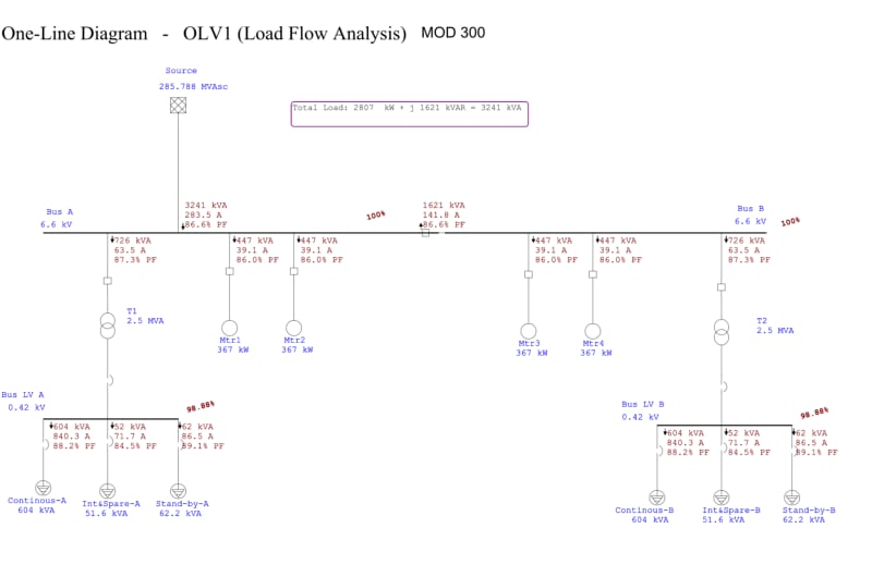

It is required is to install generators to feed loads of 2807 kW + j 1621 kVAR = 3241 kVA on 6.6kV, we propose to use 0.4 kV generators and use step-up transformers to feed the loads with 6.6 kV, my question is what is the best combination of generators for this load, is it better to use:
1- One 4 MVA generator, and one standby 4 MW generator?
OR
2- Two 2 MVA synchronized generators and other two 2 MVA standby generators.
OR
3- Four 1MVA synchronized generators and other Four standby generators.
Or there is another combination of generators to achieve best stability, readability, and efficiency, and at the same time the best fuel consumption.
Taking into account these generators should feed the loads contentiously without any interruption for 24/7 for minimum three continuous years.
Thanks in advanced.

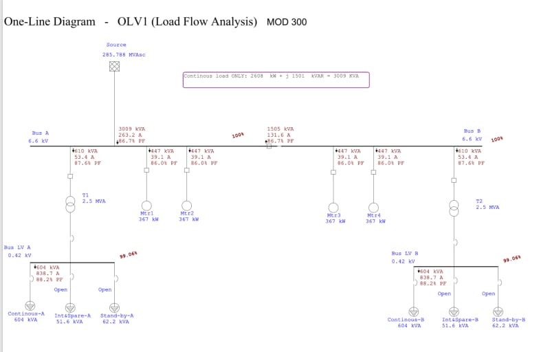

Thanks catserving, please see attached the total load and the continuous load details, the fuel is diesel.

To the OP, still not quite enough info to provide better suggestions, at least from me. You have what looks like a main-tie main bus and 4 large motor loads of the same size, so I'd guess a pump stations maybe? Do you intend on supply one side of the bus from your temp system and having a utility feed come in on the other side later in the project? Will your engine driven power system go away and be replaced by another utility feed or stay on site as a standby system?
MikeL
