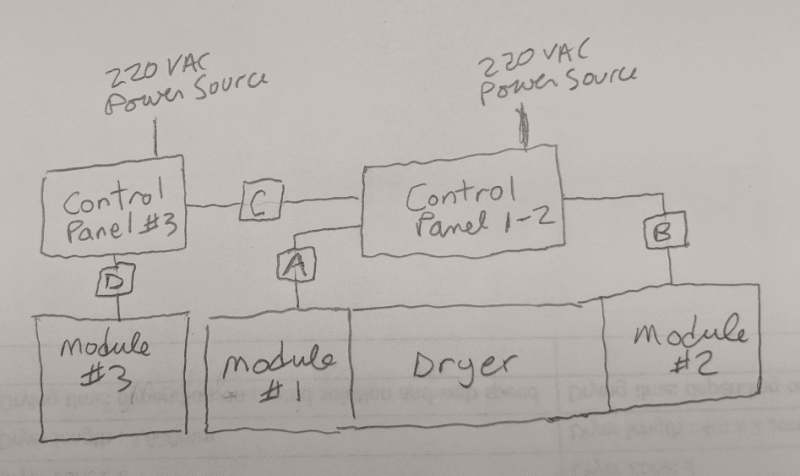

Thank you for your response. I think my attempt to simplify the description of my project resulted in my being unclear what exactly I am trying to accomplish. I will try to clarify by referencing the following illustration...
The "machine" I mentioned in my previous email is small module that will be used in conjunction with an existing machine. In my illustration, the existing machine is comprised of Module #1 and Module #2, which are separated by a Dryer. All of the controls for this machine are located in Control Panel 1-2. There is a single, dedicated 220 VAC power drop for this machine that goes into an approved disconnect in Control Panel 1-2. Inside this Control Panel 1-2, there is a transformer that transforms the 220 VAC down to 110 VAC, a 24 VDC power supply, a PLC, and a few DC drive boards (powered with 220 VAC) that drive 180 VDC motors. The motors and some operator controls (pushbuttons, selector switches, etc) are located in Module #1 and Module #2. All of the wires and cables that go from Control Panel 1-2 to Module #1 pass through Conduit A. All of the wires and cables that go from Control Panel 1-2 to Module #2 pass through Conduit B. These wires and cables are landed at terminal blocks in both locations. All power transmitted by these wires and cables is derived from the single 220 VAC power source and can be shut off using the Control Panel 1-2 disconnect.
Now, we will be building Module #3, which will perform a specific function which, when Module #3 is in place, will bypass Module #1. Module #3 will require its own Control Panel (Control Panel #3). Size, space, and access limitations make it impossible for me to mount Control Panel #3 directly on Module #3. Just like Control Panel 1-2, Control Panel #3 will have its own dedicated 220 VAC power source that will go into an approved disconnect. Control Panel #3 will have a PLC, a 24 VDC power supply, and two VFD's. The AC motors (controlled by the VFD) will be located in Module #3, as will a few operator controls (pushbuttons, selector switches, etc).
I will require some interconnect wires and cables to go from Control Panel #3 to Module #3 (to support the Module #3 operator controls and AC motors) and also from Control Panel #3 to Control Panel 1-2 (to support some limited hand-shaking between the existing machine and Module #3).
I plan to run dedicated cables for the AC motors (as these are the higher power, higher noise connections), but everything else is low power (5 VDC, 24 VDC, and 110 VAC; all at low current). I know I can install hard-conduits for Conduit C and Conduit D and land wires at terminal blocks just like on the existing machine, but being Module #3 will have to be removed occasionally, I was thinking removal would be easier if I used multi-pin connectors rather than landing at terminal blocks.
Do you think this is a bad idea? (Or an idea that might lead to violation of applicable codes)?

OK I see it now.
No chance you can mount the two VFDs on Module #3? Even Nema 4 VFDs? It constrains the VFD power waveforms to the shortest paths.

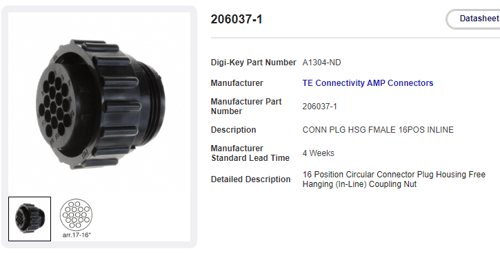

The standard is this type connector:
Amphenol Industrial Operations Type connectors.
Note: Hold your mouse cursor over the picture column to call up larger photos. (Nice!)
Often referred to as Mil-Spec connectors.
Note: They come in both sexes, reverse numbering, bulkhead, free-hanging, plastic, cheap metal, cripplingly expensive metal, solder pins, and crimp pins.
Be aware that you may need very expensive crimping tools if you go the crimp route and especially since you'll have power and control sizes (2).
Typically Module #3 would have bulkhead connectors where all the wires converge to the bulkhead connector. This eliminates strain failures on the machine side.
Use all available strain-relief options with the free hanging cable side.
They take a bit of understanding but can reliably interconnect a lot of wires. Make sure they key differently or are incompatible sexs or sizes so it forces them to be correctly connected.
Nope. Nope. As long as the connectors are voltage and current rated appropriately.
Use separate cables/connectors for motor power, VFD nastiness, and any control wiring. (Even if the same destination is involved.)
The plastic shells are cheap and adequate unless you expect abuse via yanking, or walking-on. Consider using metal for the VFD output cables.

Hi Keith,
Thank you for your response. Unfortunately, I really do have no space to put the VFD's on Module #3. I will take every precaution to use a dedicated cable/connector for the motor power cable and to use a high quality, symmetrically grounded cable as recommended by the drive manufacturer. For my control wiring, I will read up on what AMP has to offer. I have actually used the type of connector shown below before in temperature control applications in which I used the same connector to pass a heater power connection (only about 3-4 amps) and an RTD connection. I did have to buy the expensive crimp tool. The toughest part was that I used 18 AWG high temp wire for the power wires and the RTD was a much smaller gage. The 18 AWG was easy to crimp, but the smaller gage was a challenge with the same size pins/sockets. I ended up getting it to crimp quite nicely by stripping a little more insulation off the RTD wires and bending them back over themselves before crimping.

Contact Electronics makes 4 pin power plugs and 4 to to a kajillion pin control plugs that can be ordered with a famale NPT conduit hub and can be used with liquidtight flexible metal conduit to solve some of your noise problems with the 120 volts and the VFD. These can also be ordered with mechanical pins to keep 2 seemingly identical plugs from being swapped.
