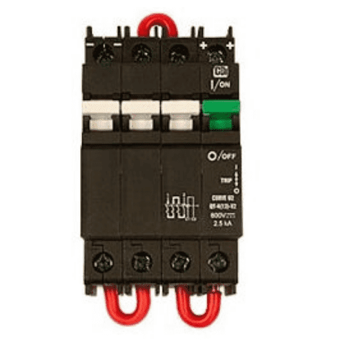

I would qualify that statement. That would only be the case if the base design of the contacts was 600VDC, because using them at a lower DC voltage is never a problem. OR it IS possible that, if you have a multi pole breaker and you loop one pole back through the 3rd, so that one pole of the DC is going through multiple sets of contacts in series, THEN this can often allow for a higher DC voltage. The air gap is considered to be cumulative, so two or three air gaps in series is actually better than the rating of one air gap alone. So a number of circuit breakers with DC voltage ratings will have this higher rating, again so long as you can series once side of the DC.
Case in point:
