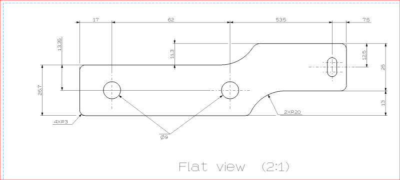

May 3, 2019 #1 CAD2015 Computer Jan 21, 2006 1,925 0 0 US Hi, Is it possible to create just one dimension for two targets: I'd like to have the diameter dimension linked to both holes... Thanks you! CAD 2015
Hi, Is it possible to create just one dimension for two targets: I'd like to have the diameter dimension linked to both holes... Thanks you! CAD 2015
May 3, 2019 #2 jackk Mechanical Nov 22, 2002 1,306 0 0 US you could add a second leader to the dimension that points to the other circle (and remove the 2X from the dimension). Not sure what you mean by "linked to both holes" Upvote 0 Downvote
you could add a second leader to the dimension that points to the other circle (and remove the 2X from the dimension). Not sure what you mean by "linked to both holes"
May 3, 2019 Thread starter #3 CAD2015 Computer Jan 21, 2006 1,925 0 0 US Thanks a lot Jackk for your prompt reply. It looks like this: I thought that Catia would allow two leaders for one identical dimension........ Something similar to adding a second leader to a text....... CAD 2015 Upvote 0 Downvote
Thanks a lot Jackk for your prompt reply. It looks like this: I thought that Catia would allow two leaders for one identical dimension........ Something similar to adding a second leader to a text....... CAD 2015
