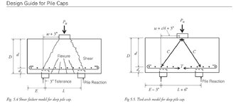

I’ve noticed engineers design 3 pile, pile caps simplified as a rectangle cap with orthogonal reinforcement how is this justified?

Orthogonal reinf. will not be effective when compared with triangular form. If you write ( pile cap for three piles ) and search the web , one of the outcomes;
Besides main diagonal reinf.Provide minimum orthogonal cage reinf. for all faces .

The 3 pile layout is still common though, and rebar is detailed without going diagonally generally.
I'm not sure that it is justified. Yeah, sure, you can get your moment capacity to calc out based on the summation of vector components etc. But that's not the entirety of the design and, in my opinion, not even the most important part. At normal pile cap proportions, a three pile cap will behave as a deep beam element (three beams). As such, things like the proper anchorage of the primary tension reinforcement over the piles will be paramount. And a uniform, orthogonal layout is unlikely to have this without special attention to detail. In this sense, at normal proportions, I would say that a three pile cap is not just a slab.
I feel that the three pile caps being rationalized as rectangular caps with orthogonal reinforcement is mostly a product of FEM jockeys falling in love with their stress fields and forgetting the fundamentals (if indeed they ever knew them).

They do. But, as a I mentioned above, to assume that to be the end of the story is to completely forget that concrete design is all about the detailing. Very often, these vector summation exercises will fall apart in the execution of the detailing.

For pile caps I hook the bars always, lock that sucker in even if it may not be explicitly required.
Another jumping off point... Sure, hook them bars if you like. But if those bars are too far away from the piles laterally, the hooking won't do all that much good.
