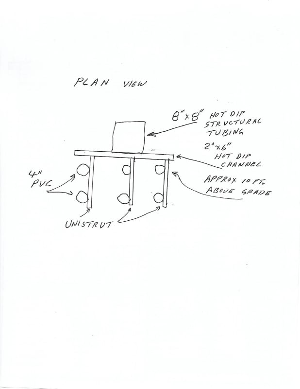

I'll draw a sketch of an installation closer to what you are proposing.

This WAS 6 x 15 Kv Cables transitioning from underground to overhead bus.
The PVC ducts approached the structure at a 45 degree angle to maintain spacing.
The individual single conductor cables were stress coned and connected to overhead bus.
