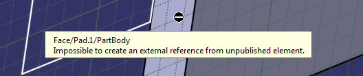

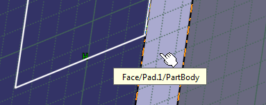

You need to check your screen because this is what you should see in your environment:
with the default option (keep link with unpublished element) you should have this:
The cursor is not the same and there is an error message (actually it tells you why you can't select the surface)
Glad you get the solution...
