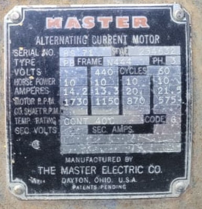

I have an old master electric company motor I'm looking for information on wiring configuration for the different speeds. It's 480 volt 4 speeds I believe it has 14 leads plus 2 extra wires I believe those are a thermal device. Leads are labeled 1 threw 7 and 11 threw 17. I have attached the name plate of the motor. Any help would be great!
I am guessing an oversized frame and two, two speed windings.
I suspect that the HP is limited by the winding ampacity and not by the frame capability.

Probably, there are two Dahlander windings.

I confirmed with EASA that it is indeed double Dahlander winding. Master was apparently early avatar of Reliance Electric.
I suggest you take the motor to a good repair shop to test and tag the winding leads and to make connections schematic for the 4 speeds.

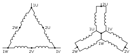

Each Dahlander winding will have normally six leads out. Measure the DC resistance of all six leads with micro ohmmeter. 3 leads will read 50% higher resistance (e.g. 15 mohms) than the other 3 leads (e.g. 10 mohms). The ones with higher resistance are for high speed and the other 3 with lower resistance are for low speed. How they are connected is shown below. Delta is low speed and Double Wye is high speed. The rotation direction should be checked after reassembly and before coupling to load to ensure same rotation direction at both speeds. For each Dahlander in a double Dahlander. [3eyes]
In double Dahlander winding, it it most likely one delta corner in each winding is opened to prevent circulating currents and hence the 14 leads the OP has posted. And it complicates the connections since the open corner has to be reconnected for that Dahlander while the keeping the corner of the other Dahlander winding open. Bummer. [evil]

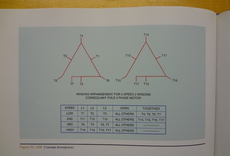

Here's what I have for a Constant Horsepower 4 speed motor. (Horsepower is the same at all speeds as denoted by the OP's nameplate photo.)
The path between T1 and T11 is permanent... and likely a internal connection... but not certain.

What does L2 to C mean?

Edison, I'm not certain what the meaning of the "C" in the L2 column indicates.
It's from Westinghouse multi-speed drum controller information and may pertain to something about the switch.
The diagram I have for the constant torque connection shows the "C" in the L1 column.
The supplied schematic at least gives the OP enough to go on in making experimental connections

The earlier posted diagram is from information published in 1956.
Here is the same information published decades later in 1999.
(I always go to my oldest sources first, and work up from there ; )
Note that highest numbered labeled leads are the high speed.

So [ based on the pic of the nameplate ] the set-up allows for the motor to operate as an induction motor having either two, three, four or six sets of poles, depending on connection; neat! And reversible to boot!
