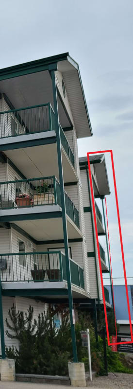

I've been engaged by a nearby condominium board to investigate settlement and lateral deformation of their building. It is a 4-storey apartment-style condominium building. Parkade on the ground level, and three floors of living space above. Inconveniently, their record drawings are complete except for the structural drawings, and I have gone on a wild goose chase for those with no luck (EOR is retired, firm that bought his company doesn't have his records, town has nothing, province has nothing). Building was constructed in 2006-2007.
The structural system is:
Main Floor: Slab on grade parkade, wood framed exterior walls.
2nd Floor: Steel transfer girders supporting 8" Hollowcore
3rd & 4th Floors: 8" Hollowcore on wood framed walls
Roof: Light wood trusses, gabled roof on wood framed walls.
Balconies are supported on exterior steel columns. There are slope issues due to building settlement.
This is the first time that I have personally seen hollowcore on wood studs. To be honest, I am skeptical that it will work out math-wise due to the dead load of the floor system. The residents have noticed some problematic vertical and lateral deflections. The vertical deflections are likely sensible given the wood bearing walls' propensity to settle with shrinkage (crushing?) of plates and is mainly a serviceability issue. The lateral deformation noted is excessive in some cases (up to H/200 as measured with a plumb bob on exterior columns) and I have concerns for the relatively heavy floors to cause ongoing P-Delta lateral deformation.
Without the structural drawings, I am having difficulty assessing the lateral load system for the building. Photographs taken during construction seem to indicate intermittent, discrete diagonal wood bracing in the party walls between units (diagonals at spaced approximately 24" apart). Exterior walls are sheathed, but no hold-down devices are in the photographs and the panel lengths are quite short, leading me to doubt their effectiveness. Overall, a very odd building and an odd combination of materials.

The H/200 lateral deformation was measured on an exterior column that supports all three levels of balconies along with the roof above. It's a 4"x4" HSS column. Deformation measured was ~2" over ~32' height. Column visually appears as a textbook P-Delta deformity:
Distortion of the camera lens may be worsening the visual appearance slightly, but never the less it was apparent while driving towards the building.

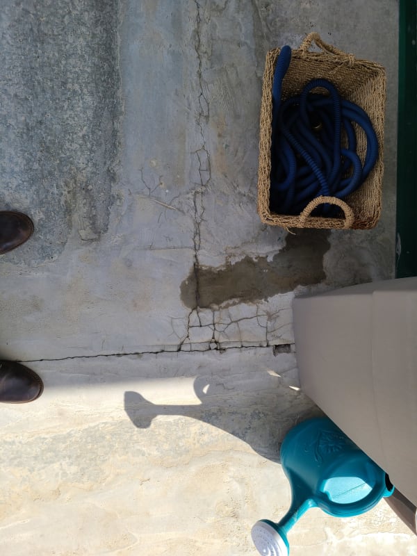

I was asked about this idea a few years ago. The biggest problem will be the connections of the HC slabs to the wood framing. It will be very difficult to evaluate without having the structural drawings or the precast shop dwgs to see what the basic plan was. From a precast HC perspective I would think the connections would mainly consist of the field guys knocking out core ends, and then putting in some type of a bolt/lag or maybe plates??? Assuming you have a topping, the knockouts will be filled when that is cast. The frequency of these connections will be very hard to assess.

- Brad805, thank you for those comments. The architectural floor types call out a 3/4" topping, but I notice that the balconies do not appear to have topping applied, and rather, it appears that a floor leveler was used to locally level the panel joints. See below.

That lateral deformation for the external column - are you sure it is caused by building movement? Maybe it was built like that.
CSA S16's tolerance for plumbness & straightness of exterior columns is H/1000. You are right that it could have been built this way, but I would be surprised to see that degree of out of plumb and out of straightness go un-noticed previously. Other balconies also exhibit similar, but slightly less intense deformation. It's not just one column.
