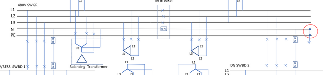

it will be a solidly grounded system to detect earth faults and the 3.7kA is on the 480V side and not on the 13.2kV side. The 13.2 kV side grid is also built by us and we are the only utility in the rural area.
Hi All, I have a hybrid power plant with PV, Battery and DG connecting to a 13.2 kV grid via a step-up transformer. the 480V side is delta which is ungrounded, how do I size a grounding transformer? the L-G fault is 3.7kA,
There was also scheme proposed like this with a balancing transformer and a neutral-earth link? what are your thoughts on this
Each separately derived system when grounded, shall have the neutral bonded to earth at one location only.
That would be your neutral to earth link.
The transformer must withstand fault current until the system protection clears the fault. That is why a resistor is used to limit the fault current.
The resister must be in the neutral conductor of the balancing transformer.
