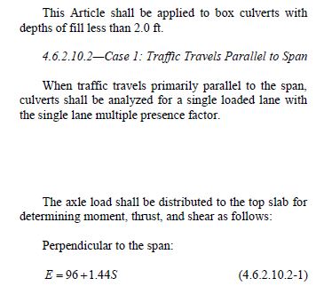

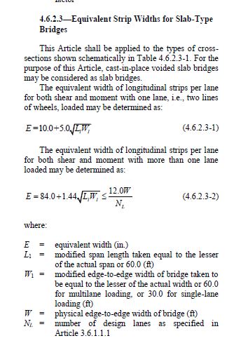

There's also this from the AASHTO bridge design spec, which may be helpful in determining the distribution width for the loading:
It's for top slabs of culverts, but it would seem to be similar in configuration to your situation.
This yields an 9 ft effective width for an 8 ft clear span. This seems excessive and also taken out of context.
I also imagine your trucks have a larger track width. A 5 ton forklift has a track of about 3.5 ft.
Actually 9 ft isn't that excessive. I was thinking of 1 wheel but it is for the entire axle.
Still, I believe the effective width equation from the image you posted would be taken out of context for elevated slabs.

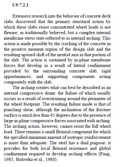

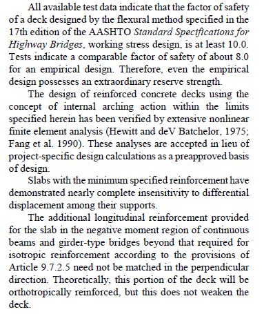

This is surprising to hear; I imagine you are referring to some sort of empirical design with shear checks built in.
Actually, no. There are no checks for shear in bridge decks. The empirical deck design specifies the area of reinforcing each way in the top and bottom layers, and that's pretty much it. From the AASHTO LRFD spec commentary:
One caveat contained in the next paragragh should be noted: "Although current tests indicated that arching action may exist in the cantilevered overhang of the slab, the available evidence is not sufficient to formulate code provisions for it (Hays et al., 1989).

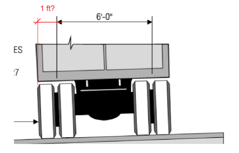

The design truck is assumed to have a 6' spacing between the centers of the wheel loads on an axle. so, to be consistent with the distribution width, the 96" in the equation would be reduced to 66" for your forklift load.
It's for the top slab of a box culvert, so a slab supported on 2 sides by concrete walls and spanning over the culvert opening in between.
I stand corrected, this equation is indeed applicable, although I believe the 96" would actually be reduced to 4'-6" (54") since the forklift tires are only about 12" wide and I believe your design truck tires extend 1 ft each side from the center of track.
This would mean for an 8ft span, AASHTO gives us about 5.5 ft of effective width for the axle, which is still far off calculation wise. I have a load of 22*1.6 + deadweight of slab and only a resistance of +- 4kips/ft for an 8" slab. This is about 75% overstressed. What is shocking to me is how the calculations are so far off - 8" slab with a 5 ton forklift is quite standard in the pulp and paper industry. Also, I understand the deck has a fair bit of shear resistance, but this is typically neglected due to corrosion.

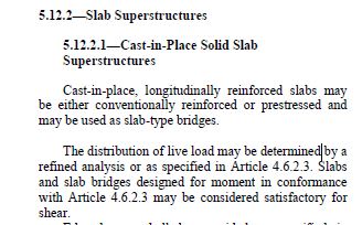

In typical slab-on-beam bridges, the slab spans perpendicular to the direction of traffic. If you meant traffic traveling parallel to the span, then the analogous case would be the top slab of a typical concrete box culvert under less than 2' of fill (including at-grade top slabs) or a slab bridge, for which we have previously discussed the distribution width.
The AASHTO spec has this to say on slab superstructures:
Here's the section referenced:

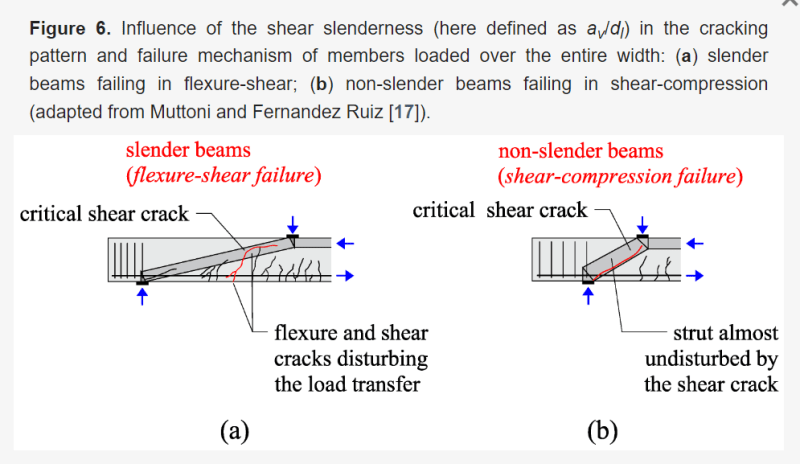

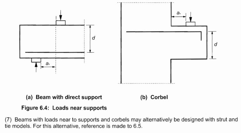

I'd like to focus on "arching action" and whether its appropriate to use with ACI.
Below is a snippet demonstrating when the load position is < 2*d from the support the shear resistance increases due to arching.
When load is placed near support, concrete strut forms, reducing the shear demand on the section.
Snapshot from Eurocode, expressing arching action as a reduction factor, beta, applied to the shear demand at the support.

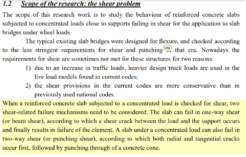

The slab I have is typically designed as one way as the width to span ratio is sufficiently large.
Anyway, this is a snippet from my previously linked article explaining that the slab could indeed fail in one-way shear.
