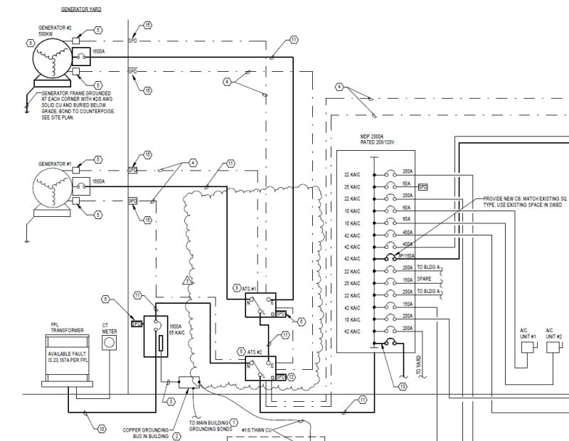

KAIC is kA interrupting rating right? How come there's all sorts of different ratings on the one board?
EDMS Australia
Yup, kA. killo amps interrupting. The numbers correspond to the rating of each individual breaker rather than the board itself.
I would think the kA rating would also apply to the board also, as the magnetic forces acting on the bus bar during a fault would cause a bending of the bus bar. So that bus bar would need bracing to handle that force.
cranky108, it generally does, which means that putting a breaker with less rating than the board is not acceptable.
Also one of the reasons I asked, particularly when there's a 10kA 200A breaker mixed in with a bunch of 42kA breakers.
EDMS Australia
You can have lower rated breakers if they are approved as a series rating. Though I think the main must be in the panel itself for that to apply- not 100% sure.
