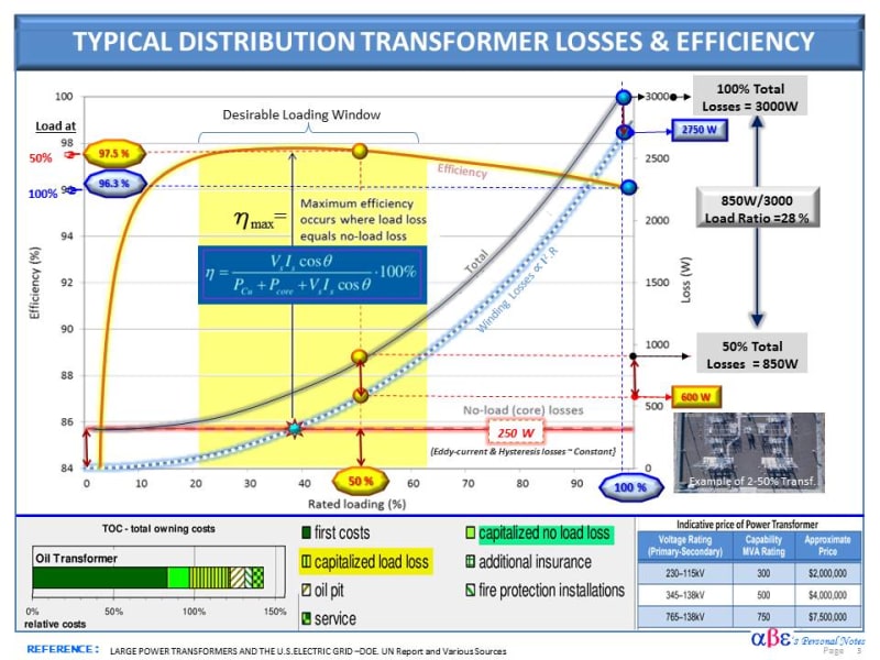

Below is a shape of loss-efficiency curve that hopes to help to visualize the losses for 50% and 100% loading transformers and associated losses.

Transformer cost and losses vary as MVA raised to 0.75 ratio ie 100 MVA transformer cost and losses will not be two times those of 50 MVA, but 2 raised to 0.75 ie 1.7 times of 50 MVA. It is always better to go for 2nos P rating ( provided your MV breaker rating is not exceeded) with both loaded at 50 % of total load. Remember any transformer kept in deenergized state is prone to absorb more moisture than a loaded transformer. Paper aging also will be less in a 50 % loaded unit, giving more life.
