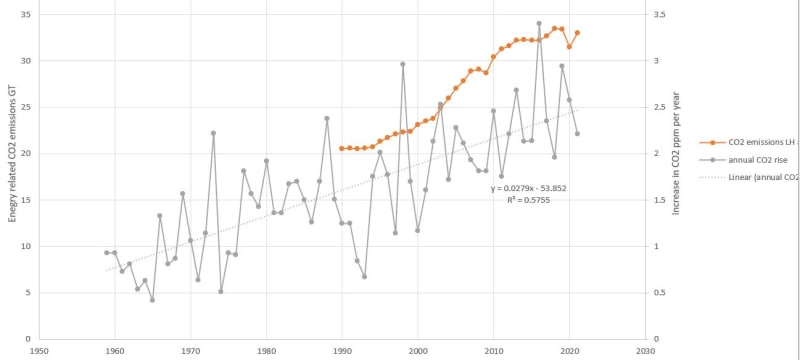

The gold standard of CO2 measurements is Mauna Loa.
CO2 is well mixed in the atmosphere.
The mass of the atmosphere is 5e15 tons
M-L says CO2 is increasing by 2-3ppm every year (2.8 is a long term average) The IEA says we release about 32 GT of CO2 per year for energy related use
Maths
5e15T*3e-6=15GT
Hypotheses
1) one of my predicates is wrong
2) I can't do maths
3) ML is not measuring CO2 very well
4) There are negative feedback loops pulling half the additional CO2 out of the atmosphere every year
Discussion
Assuming 1-3 are irrelevant, something is eating half our CO2 within a year of it being emitted. If CO2 emissions reach net zero (they won't) then CO2 levels will fall by 1 ppm per year, at least initially. But if we got to 50% emissions, ie 16 GT/year, we'd expect the CO2 ppm to stabilise. The odd thing is that we were at that level of emissions in 1975 (approx), and yet we still had 1.2 ppm/year.
So there seems to be an absorption mechanism that is more active now than it was in 1975.

Ack, I've just realized, the driver for seawater is excess ppm, so if 280 is the long term equilibrium then in 1975 it would have been 330-280=50, and in 2021 416-280=136, so in fact it has the right sort of behaviour.
Good oh
Estimated mass of plants is 450 GT and "For the period 2003-12, we found that the total amount of vegetation above the ground has increased by about 4 billion tonnes of carbon.", ie about 0.5 GT per year, nowhere near enough to explain the missing CO2.

Oh this is great, I misread my own graph. Damn. So here's a plot of energy related CO2 emissions per year, in GT, and the CHANGE in CO2 ppm per year (I thought it was ppm in my original post). As I said it is well described by a straight line, but of course the slope is the second derivative of ppm, so ppm is accelerating.
Luckily the recent ppm/year is about 2.5 so I think my initial calculations above were roughly right, but the comment about 1975 is wrong.

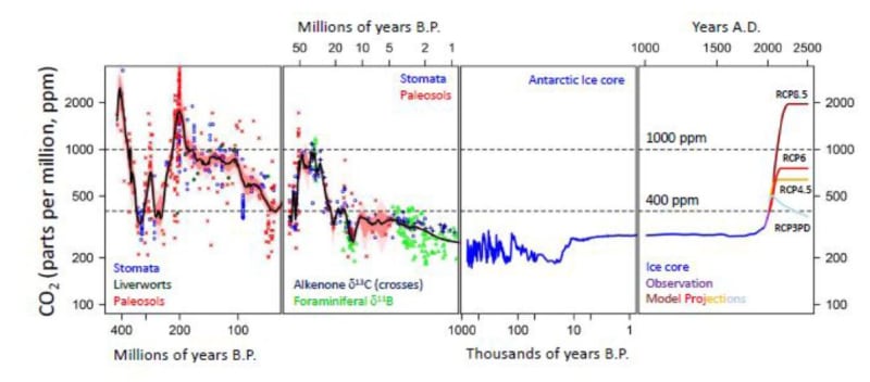

The pseudo experts that claim there is fossil oil in the ground, should not be concerned with any release of Co2 from that oil what so ever. Since said fossils once lived on the earth just like vegetation so that makes said fossils, carbon neutral.
Yeah, but when the vegetation that formed that oil was alive, the CO2 ppm was about 4000-7000, and temperatures were around 5-15 deg C hotter. So while there is no doubt that animals and plants can live in those conditions, abundantly, it would be a very different world, for a start the sea levels would be a couple of hundred metres higher. OTOH dragonflies the size of vultures, I'd like to see that. Anyway even at current rates of burning fossil fuels we won't be up to 4000 ppm for many centuries.

CO2 levels... from one source...BP- Before the present time. The CO2 is the highest it's ever been since human life has been on earth 2-4M years BP.
