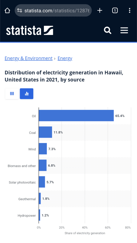

It appears to me like you're taking his posts as personal insults against you. I don't read them that way at all. I think his follow up posts make that pretty clear.... Especially the ones where he included a chart that he neglected to include in his previous post or where he pointed out that he was not considering biomass to be renewable. I suppose, he could be baiting you (or us) into flaming him so that he can appear to be the reasonable one. But, if you think he might be doing that, then I suggest you shouldn't take the bait so eagerly.

With that said, your chart shows lower renewables than the one I linked. Yours is slightly over 10% while the one I linked was 16%.
Regardless of our data sources, the grid demand doesn't fluctuate from 100% to less than 15% under any conditions. Sure, renewables may contribute more than 15% depending on conditions and time of day but again, it's likely nowhere near the base load. In these cases any benefit from a battery system will be directly the result of creative accounting.
I didn't post a chart or a link to a percentage production chart, so what exactly are you spewing on about here?
