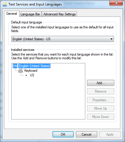

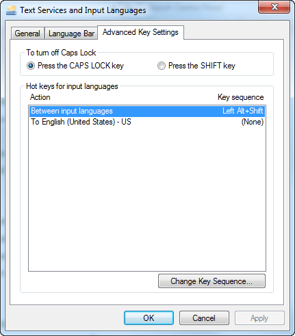

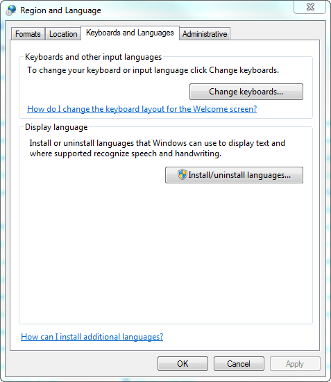

Try holding the leftmost alt button and tapping shift. This appears to be the default way to switch between different installed keyboards.
You can see which keyboards are installed in Control Panel / Region and Languages / Keyboards and Languages / Change keyboards.
Here are what my settings look like for reference.
Thanks JG2828!
That saved me a phone call to BG.
LOOK: ÅÖÄ, no probs and this: ÅIÅÖÄEÖ, which means "and, in the river there's an island"
Everything works again! Even l'accent égu et grave: à quel prix?

Addendum: The ALT/SHIFT worked on first try.

Maybe. Or maybe you accidentally clicked alt and shift. Clicking this does nothing for me since I only have one "keyboard" installed. You could remove the one you are not using so it doesn't happen again.
Sorry for late feed-back.
Uninstalled all keyboards than SWE.
No more surprises.
