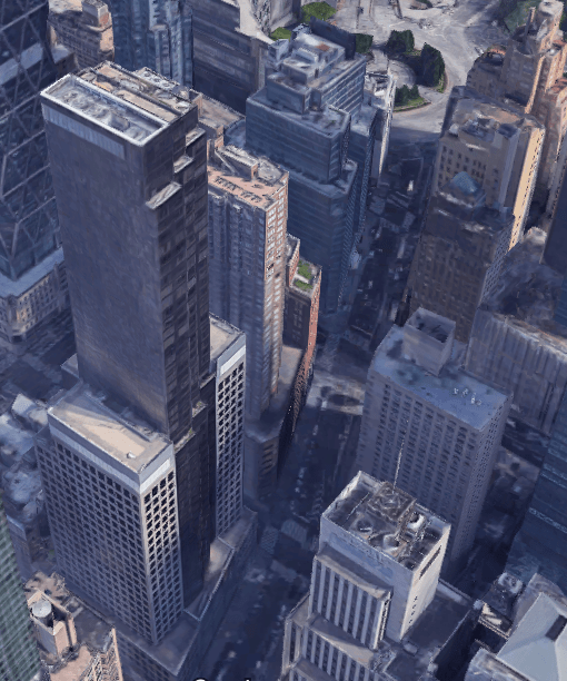

Now I actually have a google earth problem, I have seen reports from competitors which use google earth elevations to perform feasibility level hydraulics. To which I comment to my clients that I will not be relying on the topography from Google Earth to perform any engineering and they can either get lidar/drone mapping for there property or we will use government baseline mapping which is a slight step up from google earth but it has been furnished by the government.
There are a couple of other reasons to avoid Google Maps/Earth for anything serious, see below. Also, Note that satellite imagery is often shot at oddball angles, so perspective is warped, and finally, the placement of features is no more accurate than around 10 meter SEP
