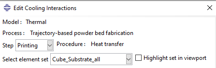

I am working with a 2023 version of Abaqus and am having trouble regarding the AM Modeler Plugin's cooling step. On one hand, if I don't define any interactions in the Thermal model, it gives me the following error upon clicking on the AM Modeler Cooling tab:

On the other hand, if I define a surface film condition (int-1) and a surface radiation condition (int-2), there's a glaring error in the Abaqus AM Cooling tab where it asks me to select an element set rather than a surface even though int-1 and int-2 itself selects a surface.
The following is the error associated if i just continue. :

Are there any suggestions on what is the correct way to take into account the cooling effect while running the thermal analysis in the GUI?

You should only define cooling in the AM Modeler plug-in, not manually create interactions in the Interaction module. Element set is selected because it's progressive cooling taking into account evolving free surfaces of mesh elements.

As you had suggested, I removed the manual creation of the interactions and tried to only define the cooling in the AM modeler plugin. However, I still receive the error:

I understand that the cooling tab is trying to select an element set, but if so, why is a surface region mentioned in the ValueError line?
Behind the scenes, is the AM Modeler cooling tab just trying to make a Film and a Radiate subroutine (allowing for the element selection rather than ), or is it a completely separate thing?
