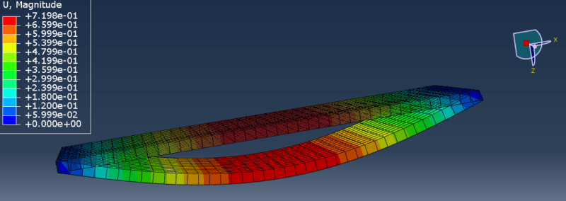

I have modelled a concrete slab in Abaqus and i get a big difference between my hand calculations of the deformation (which i am pretty sure are correct) and my deformation results from Abaqus.
I am pretty sure there is something wrong in the model.

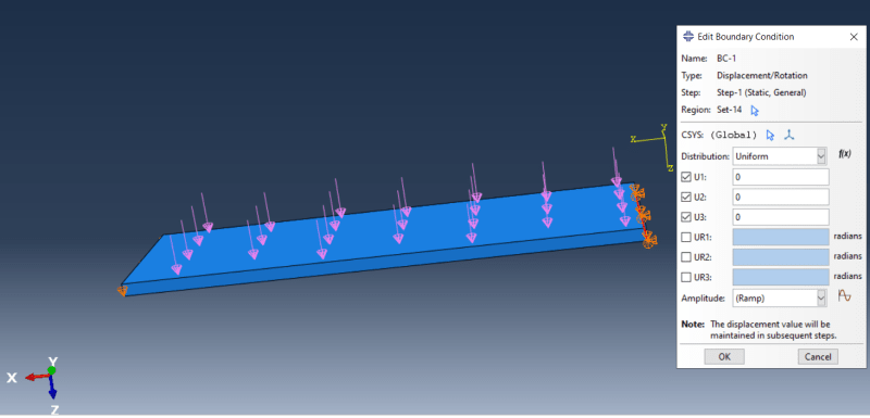

Boundary conditions: locked in Z at one end and locked in Z and x in the other end
I get a max midspan deformation of about 0.68 m in Abaqus and 0.068 m in my hand calculations. There seem to be an additional multiplier of 10 somewhere in Abaqus, or the correlation between the results may just be a coincidence. Any guidance on this problem would be greatly appreciated.

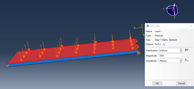

Can you share a screenshot showing your Abaqus model with boundary condition and load symbols ? The description leaves some doubts.
Thank you for your reply.
I attach 3 images showing load and bc symbols and values. Is it something i should change?
My hand calculations showed a max midspan deflection of 3.5 mm, my Abaqus model show 700 mm... Something is horribly off. Any ideas?
I get the deflection of 0.00848 m from analytical calculations and this is in agreement with analysis. You should definitely refine the mesh, especially add more elements in the thickness direction. Also, double-check all the inputs.

I have double checked all my inputs and refined the mesh, thanks for the tip. Now i am getting about 0.009 m in max deflection. Could finer mesh move the deflection closer to 0.0035?

Oh wait,
i forgot to multiply my load with the width of the floor in my analytical solution. Now i changed it to: u=(5*qtot*L^4)/(384*E*I), where qtot is 3500*2.4. With that correction i get 0.00848, which Abaqus now shows with a finer mesh.
