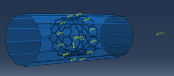

I am trying to apply an inward, radial displacement (smooth step 0->1) to the centre of 12 rigid plates (reference point at the centre of the plates), that are ordered in a cylindrical manner.
I am using the general contact method with the following interaction properties: Tangential -> Penalty -> Friction Factor =0.1 and Normal -> Hard. I have also used tie contacts between the cylindrical coordinate centre (RP1) and at some point from the geometry (RP2), where RP2 has an encastre BC.
I have used semi-automatic mass-scaling and have applied mass-scaling to poor-mesh-elements using the minimum time increment specified for the free tetrahedral mesh (seed size 0.1 and element type 3D element).
I have set used the point mass/inertia for the rigid plates: mass of the rigid body to be 1 and the rotational inertia (no diagonal terms) to be 1 also. The reference point is at the centre of the rigid body.

Have you run explicit analyses before? Do you know if your stent is sufficiently constrained? Not sure why you have multiple rigid plates; usually, these sims have a cylinder with BCs specified in a radial coordinate system.
Take a big step back and ensure: 1) BCs are applied as you expect in a test copy of this model. In that test copy, you could remove the stent altogether. If the crimping tool moves as per the BCs, great. 2) In another test copy, get rid of the crimping and apply a simple point load somewhere on the stent. Do you see stresses in that point load location or does the stent fly away? If the animation shows the stent flying away, your stent isn't constrained appropriately.

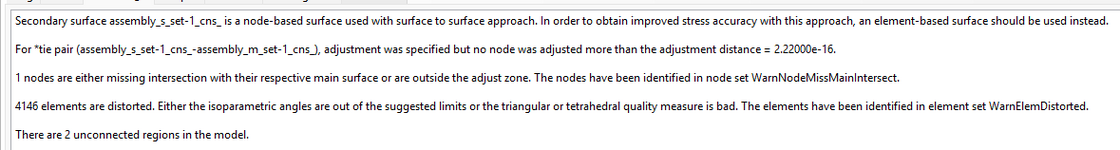

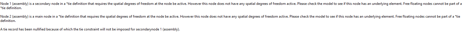

I believe that there are issues with how i have defined my tie constraints, I did get this warning when running my simulation in regards to this:
I am not sure how I should constrain my stent so that it does not move during the process. I have just applied coupling constraints and it has gotten rid of this error in the data file and in the warnings. I have applied this to my main model, as I have made some adjustments.
However, I still cannot get rid of the warning regarding the displacement, is this something that can be ignored as i have applied a smooth step displacement BC. Also could you please advise me on how to refine my mesh since this warning continuously pops up:
5117 elements are distorted. Either the isoparametric angles are out of the suggested limits or the triangular or tetrahedral quality measure is bad. The elements have been identified in element set WarnElemDistorted.
I have just used free tet mesh on this with 3D elements and growth rate of 1. I am not sure how to resolve this

1) The crimping tool can be very close to the deformable surface. Cylinder should work - it works for everyone.
2) A node on the stent can be fixed in the out-of-image (Z) direction at least until the crimping tool comes into contact with the stent and friction prevents it from slipping away. So, you may consider performing a two-step analysis with the stent fixed in the Z-direction in the first step while the crimping tool starts to come into contact with the stent and then, in the second step, releasing the Z-constraint on the node and continuing with the crimping.

What I have done so far -I have gotten rid of the tie constraint warning by implementing kinematic coupling constraint between two reference points.
The main warnings I get now are the displacement jumps, OP=Contact and the error with my mesh quality. For the mesh quality I have tried making it coarse but I still get the same error, I’m not sure how much more coarse I should make it or if there is anything else I could do.

I can't see the geometry of your model well but it looks like a wire stent with hexagonal cells. Did you consider modeling it with beam elements, at least initially to significantly reduce the size of the model ? The Wrap Mesh plug-in available for Abaqus/CAE will allow you to start with a 2D pattern and then wrap it to create a full cylinder. Tetrahedral elements should be avoided if possible.
