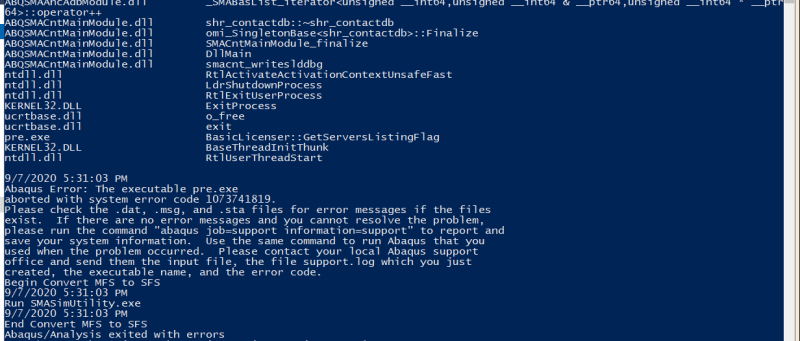

However I have a new issue - when my job begins to run it then says "an unhandled exception occurred" and quickly aborts and says it "encountered EXCEPTION_ACCESS_VIOLATION in ntdll.dll (code 3221225477)". It also says that the executable pre.exe aborted with an error message 1073471819.
I thought that it might be because my job is too large so I tried using a coarse mesh and ran the job again. It appeared to be doing more this time as it got past the "run pre.exe" stage and began the "run standard.exe" stage, but then suddenly aborted again without giving me an explanation or error code.
The images below show the error messages in my command prompt window (or PowerShell) in my case. These first 2 are for my original job;
and the third image is for my job with the coarse mesh:
I have also attached the .msg file of the coarse mesh job if that helps.

Sometimes such ambiguous error messages are actually caused by modeling issues. In this case the .msg file contains typical message indicating convergence issues: "Too many attempts made for this increment". There are also some warnings regarding numerical singularity/zero pivot in this file. It seems that your model is underconstrained.

Most of the nodes of zero pivot or numerical singularities are in the portion of the steel ED bars which are unbonded to the surrounding concrete. I was unsure of how to have it unbonded so I didn't apply any constraints or interactions here, and simply embedded the remainder of the bars in the concrete. What would be the best way to simulate this?

You should either apply embedded region constraint to these bars or fix them with some boundary condition. Otherwise they will be free to move causing rigid body motions and thus numerical singularities.
It appears to be running and working properly now, thanks for your help!
