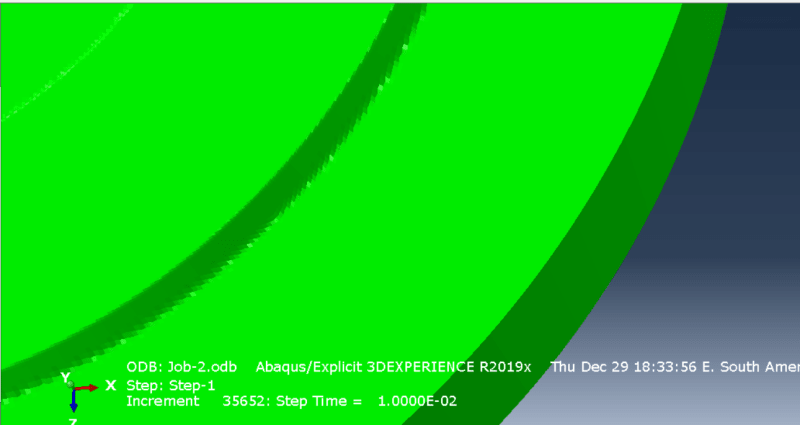

I'm trying to simulate a coining process with microgeometry with 0.2mm in the width relief, and I noticed some poor aspect in the final form of the coin. The Figure 1 shows a quarter of the coin and a bad appearance in the contour of the relief with bright spots.

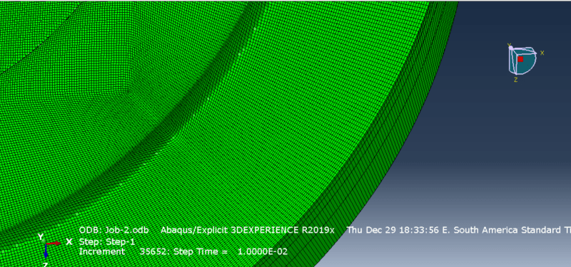

The figure 2 gives a zoom on a local width of the relief where we can see the distortion of the elements in a way that doesn’t seem normal.
I’ve tried different parameters to improve the quality, such as: refining the mesh of the blank, refining the mesh of the punch, rounding sharp corners, reducing mass scaling and time scaling, changing the hourglass control method, choosing different contact approach (general contact and contact pairs), removing friction or inserting a maximum shear stress, but nothing seemed to work efficient.
Any suggestion on what I should try?

Naturally, refining the mesh will help, but I don’t think it is only that.
I generated a simpler model to analyze the mesh faster, and when I double the number of elements the changes are not significant in the appearance of the coin.
The figures below show the simpler model with a relief height of 0.2mm. The elements have an average minimum edge length of 0.0183mm, and shortest edge of 0.00774mm.
I could refine even more, but it would be an excessive fine mesh for all the other analyzes that I intend to do, considering that I’m getting similar contour plots for strain and stress. I will compare latter the Force x Displacement curve with an experiment too.
Do you think is happening an hourglass effect due a local bending? Or maybe a contact issue? Or even something that I could improve with Light Options settings? Because if you pay attention in the second figure with all edges visible you will see that the effect of the distorted elements is less apparent. Rotating the model the bright spots change too.

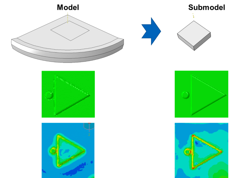

Is it possible to use Submodels to analyze some specific regions in contact problems like that? I'm trying to make a submodel including only the triangle geometry in order to check stress concentration with high accuracy using a fine mesh. The image below shows the stress distribution for the model and submodel.
This procedure can be applied for contact problems in metal forming?
Tks
Node-based submodeling is quite versatile, it can be used for analyses involving contact and those performed in Abaqus/Explicit. Its limitations are listed in the documentation.

I'm a beginner in submodelling. So I would like to share some settings that I'm using in order to see your opinion.
In the Global Model (the 1/4 part of the blank showed in the previous image) there is a boundary condition (BC) related to the vertical displacement (axis y) of the die to do the microforming process in the blank.
In the Submodel (the small paralelepiped in the image) I kept all parts (blank and die) in the assembly, and applied the same vertical displacement as a BC.
For the driven region of the submodel I insert 1 and 3 as x-axis and z-axis degrees of freedom that will be interpolated from the Global Model, and keep the DOF 2 out, considering that I'm already using a BC for the y-axis.
Is it seems right?
Tks again.
Yes, it should be correct but I would set that second DOF to driven too. Especially since it's not applied to the faces of the cut in the original model but probably to the top surface only. Regarding BCs, you can find some tips in the documentation chapter Analysis --> Analysis Techniques --> Modeling Abstractions --> Submodeling --> Node-Based Submodeling (paragraph Boundary Conditions).
