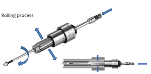

Hello Everyone,
I need a help regarding simulation of tube rolling process which constists of 3 rollers that are radially expanding and rotating.
First thing first I'm trying to conduct simulation of just one roller kinematics so that the roller expands and rotates.
I need to have roller expansion and rotation (around center of the tube - center point), but when using coupling constraint Roller_reference (RP) is moved with the roller from the center point and the rotation is then from this reference point that has been moved with the roller from the center of the tube
When I try using 2 reference points sometimes it gives certain errors due to this.
Thank you for your help.

Hello,
Find the screenshots in the attachment of the simplified model and also of the rolling process.
Additionally explanation of the tube roll expansion process can be seen on this YT video:
I have manage to get both rotation (STEP 2) and radial expansion (STEP 1) in this order using hinge connector
If I have first radial expansion and then rotation around central axis RP_C the simulation is aborted or the result is not okay, I belive reason for this is the cartesian coordinate system, not sure if cylindrical coordinate system might help?
On the picture "Roller after 1_STEP rotation and 2_STEP radial expansion" you can see the roller doing one full circle of rotation after which he is radially expanded in X direction
On the picture "Roller after 1_STEP rotation, 2_STEP radial expansion and 3_STEP rotation" you can see what happens once you apply rotation of roller after radial expansion (movement in X direction)
For the full simulation I will have 3 roller, the simulation will consist of few steps in which I will gradually increase the radial movement of the roller with the constant rotation of the roller around center axis.
The biggest problem is how to prescribed the radial movement out from the central axis so that the roller during rotation has same radial distance from the center axis as for now I give certain X direction displacement and during rotation it causes problems as seen on the pictures (just my opinion)
Unfortunately I couldn't attach the videos.
Best regards
