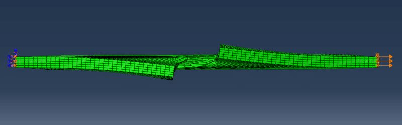

Hello everyone,
I have a laminate model composed of linear element sets of matrix and truss, designed to analyze crack development within the laminate. To simulate a crack, I created a notch by modifying the .inp file and importing the model as an orphan mesh. Currently, I'm exploring methods to refine the mesh specifically in the crack area. I attempted subdivision, but unfortunately, the model did not converge, and only one increment was successfully completed.
The .inp file is attached
Any suggestions or alternative approaches would be greatly appreciated.

When I submit this analysis, it reaches 71.9 % before diverging. In the results, you may notice a significant distortion of the elements in the crack region while the top and bottom parts of the sample not only stretch but also bend sideways.
