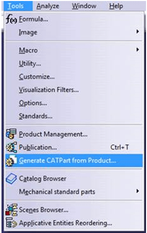

When analyzing an assembly group, is it good to take the whole group into catia and analyze it by installing constrains between them? Otherwise, would you recommend meeting and analyzing the entire product in a lot. Assigning constrains to the Product will also result in a separate time spent.
Also, in this case, even though the material was assigned to each body, I saw that only the main partbody was analyzed. Other bodies need to assemble (add) to the main partbody. In this case, if a piece is plastic, for example, does catia give its plasticity to the body in the analysis?

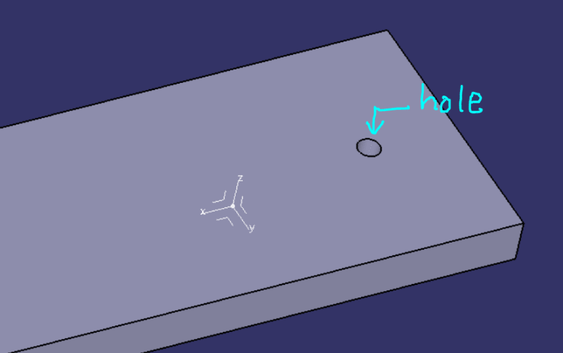

by close holes, something like this? Mean

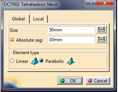

How would you suggest to write the rate here in the analysis? As below x / top 5x = 10/50? It may change depending on the part size, but?

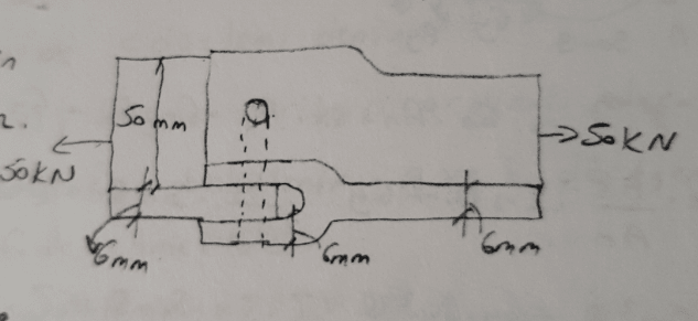

This is a simple example but it is not working / I could'not do it.
I want to see same results with my book to understand I am on true way and I believe catia static analysis give true results.
