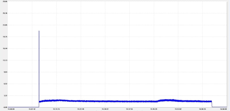

I have a AC motor 1250kW 6000V 3 phases. It has a high horizontal vibration of 21-29 mm/s on a non-drive end bearing during the starting time (1-2 sec) at full load.
Then, the vibration is ok , about 1.9 mm/sec.

Vibration vs time at full load. There are rolling bearings

If you have a Rotor bar problem, it will show up in the steady state FFT, Spin up vs spin down is only to tell if power vs no power is different. I would look at the data coupled first. The trace above seems to indicate Start and stop are different, so a complete FFT may be in order.
I was not thinking that an FFT for a one second period would be usable, but an expanded trace with a large number of samples during spinup and spindown could reveal something about resonance.

I reckon, the reason why in the end it doesn't have peak because it slowed down by the pump quickly.
I will measure vibration without load.

I reckon, the reason why in the end it doesn't have peak [after stopping] because it slowed down by the pump quickly.
But it starts at least as quickly as it stops, doesn't it? If it was a resonance, I don't see why it would peak during start but not during stop.

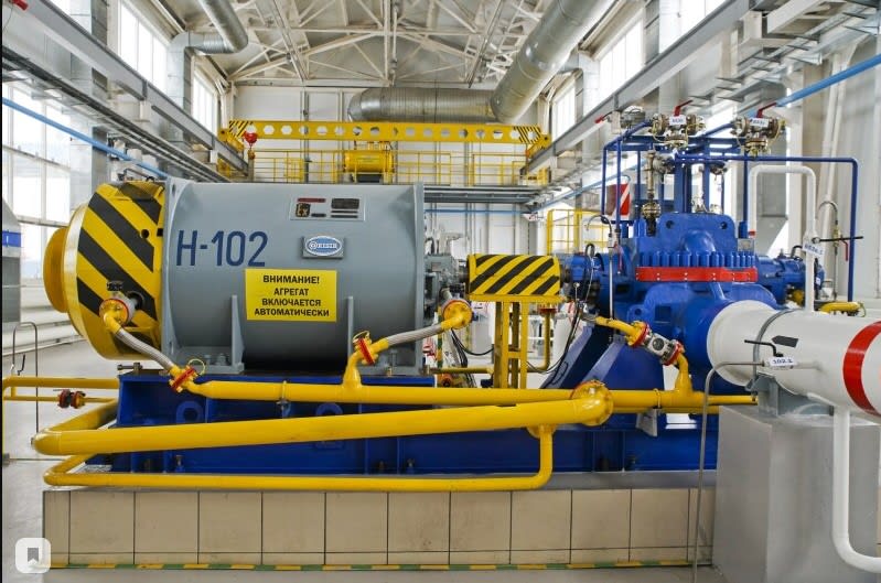

Is the pump impeller supported on both sides or is it cantilevered?

DE side pic below. Startup max vibration is 2.2 mm/sec
Another motors show different startup vibration but lower than 18 mm/sec.
Pump impeller is supported on both sides. Picture below.
