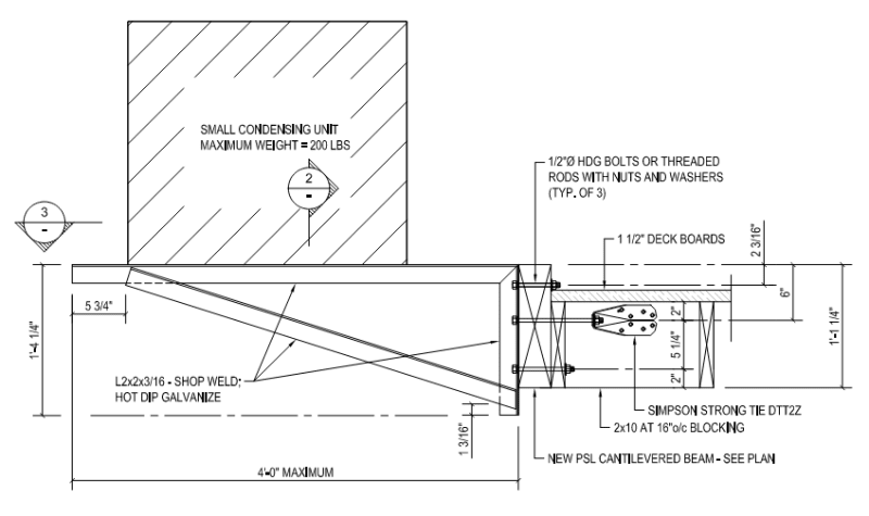

I'm with XR - incorporate support for the AC units into your design. Those brackets have a very small bearing area in the compression zone that will cut into the wood, especially when wet. I'm surprised it's not happening already (though, it could be - not the best pictures for seeing that). If you have to reuse it, maybe add a galvanized plate to the side of the beam to help distribute the bearing pressure. The torsion can be resolved easily enough.

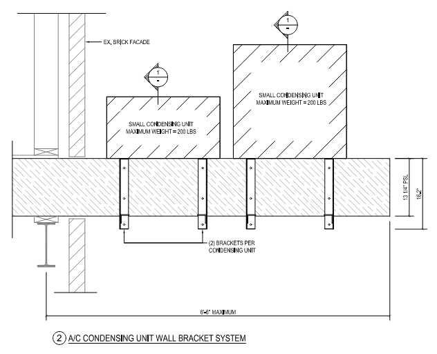

I did this design, which is loosely based on an a/c bracket support that I found online. I would have just spec'd out that wall bracket but it was calling for 3/8" lag bolts and I wanted to use these 1/2" threaded rods so I could utilize the Simpson Tension Tie.
I am open to criticism.
What is holding your blocking in place? What happens when they use decking with a hidden fastener system that does not provide lateral control of the joists?
