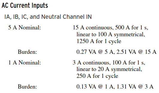

Here is an example from an SEL-351 relay.
The 1A current inputs will take 3A continuous, 100A for 1 second, and 250A for 1 cycle.
Maybe someone here can explain what "Linear to 20 A symmetrical" means in this context.
davidbeach, that's what I would have expected as well, the difference between physically being able to withstand the current versus the means to measure the current. I'd imagine that above 20 x the rated current, there's probably not a lot of resolution needed to work out that you'd want it to trip.

I believe it has to do with the size of the registers used for measuring the currents. I don't think you are even allowed to set pickups above 20x amp rating in SEL relays. Most CTs at least on the transmission and distribution level are guaranteed no more than 10% error at 20 times rated current at rated burden for symmetrical currents. For example, a C800 CT is designed to handle 5 x 20A = 100A at 8 ohm burden with no more than 10% error. CTs can handle more than 20x symmetrical if the burden is less than rated but SEL probably just picked the size of the registers as what they are to use rated values. In my opinion, someone is using bad CT ratios if you are ever approach 20x rated current on the secondary.
