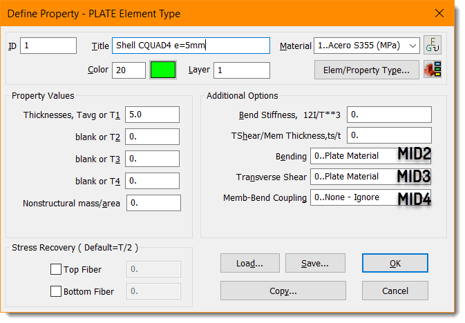

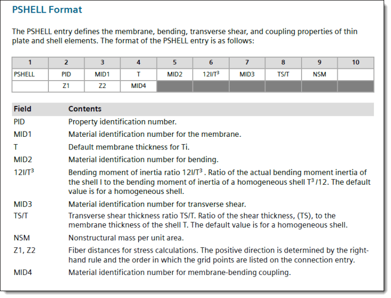

Dear Giovap,
In the blog of Simcenter FEMAP & NASTRAN I explain the differences between the formulations of Kirchhoff-Love vs. Mindlin-Reissner shell elements for thin & thick plates.
In your case of plates with thickness = 45 mm you can mesh perfectly with 2-D shell/plate elements of element size = 50 x 50 mm.
In case of using Simcenter FEMAP with NASTRAN, the following image shows the definition of the Property of a Shell element in Simcenter FEMAP: the fields with MID2 and MID3 are always active by default, the material is assigned automatically, therefore the Shell elements defined in FEMAP include by default membrane rigidity, bending and shear stiffness term, and are ready to work with thin and thick plates, not problem.
Best regards,
Blas.
