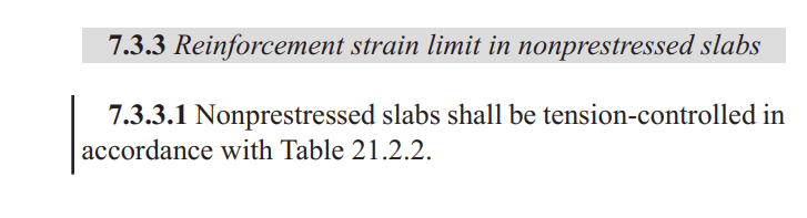

Can anyone confirm that ACI 318-19 now requires beams and slabs to be tension-controlled? I heard this mentioned at a seminar, but I do not find it in the code iteself. Table 21.2.2 still gives phi as a function of whether the section is compression, transition, or tension-controlled.

Best I can find in the code to this effect so far is 8.3.3.1 and 9.3.3.1

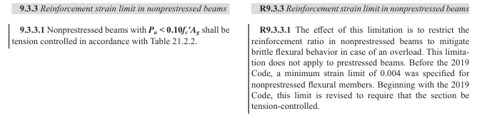

I think I traced the reference I heard to the sections listed above. In the past, you could have a compression controlled beam section but with smaller phi. Now the practical limit for strain is .003 + yield strain for the steel.

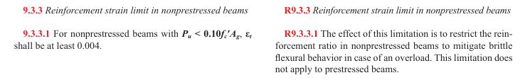

You could never have a compression controlled non-prestressed beam, there was a limit on the extreme tensile strain of 0.004 (think this was introduced in 318-02)

The beam requirements always superseded the phi factor table and required a minimum extreme tensile strain of 0.004, revised in 19 to be 0.003+ey. Compression controlled non-prestressed beams have never been allowed per code.
edit: non-prestressed beams with Pu >= 0.10 f'c Ag were excepted from the strain limit.
Celt83, yes that's the new requirement I was referring to. That is new in the 19 code.
DTS419, that requirement is not new the strain limits have been in place since at least ACI 318-02. The change in ACI 318-19 is that you are no longer allowed to dip into the transition zone (0.004 up to 0.005 tensile strain with 60 ksi steel).
relevant section of ACI 318-02 through 318-11:
The section moved to 9.3.3.1 in ACI 318-14:
And then in ACI 318-19 9.3.3.1 was revised to enforce "tension controlled" sections:
That's right, the "tension-controlled" part is "new" in 19.

my post is illustrating that compression-controlled beam sections were not acceptable per code from 318-02 through 318-11. 318-14 revised the language to allow any member with net compressive Pu above the lower bound of 0.1 f'c Ag to use a lower phi, in my experience it has been very rare for beam/slab sections to satisfy this requirement.
