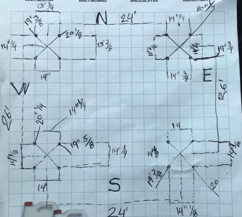

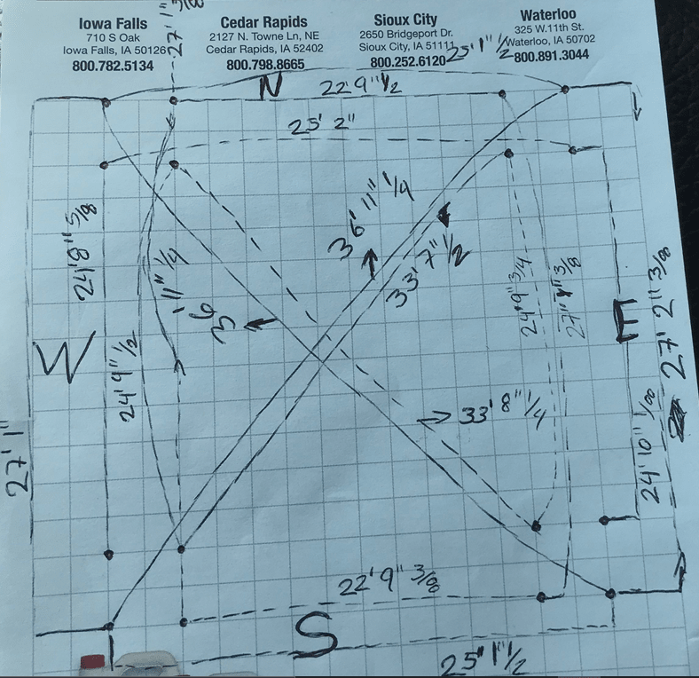

I'd prefer the single plate, for the sole purpose of it removes one more stupid thing the contractor can get wrong. It holds all the bolts in the correct orientation relative to one another, that is a win in my book. I'm sick of seeing butchered base plates and being asked after the fact to justify it. If the contractor just has to consider getting the location and orientation as a whole in the right position, it is arguably better in my experience than having to do the same with 4-8 individual bolts and ending up with god knows what. I disagree that is it a significant point of weakness but I guess it's all relative the application and loading, provide all the shear capacity in reinforcement in the plinth if there is a concern, and stop relying on the tension capacity of concrete?
wineland said:
What, you don't like getting photos of field notes from your contractor that look like this?
No doubt those sketches were part of a RFI that reads: "URGENT!: anchor bolts for braced frames misplaced. need epoxy fix ASAP! Crane waiting on site burning through budget."
