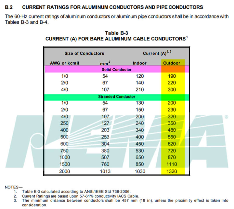

NEMA Standard CC-1, ANSI/IEEE Standard C119 :
a) The ratings on Table are given for a wind velocity of 2 ft/s, an ambient air temperature of 40C, a conductor temperature of 70C (30C rise), and emissivity 0.35. Sun effect was not taken into consideration because of the wide variation depending upon the location.
b) The designer should recalculate these values to take sun effect into consideration once the installation location is determined.
c)The temperature rise shall be determined at 100, 125, and 150% of the rated current
d) is not intended to qualify the connectors for service higher than the normal rating.
e) Connectors that are supplied in equipment are covered by the equipment standards and are excluded from this standard.
f) If the user desires to operate the conductor and connectors at a higher temperature rating, the test currents shall be raised to a value agreed upon between the manufacturer and user.

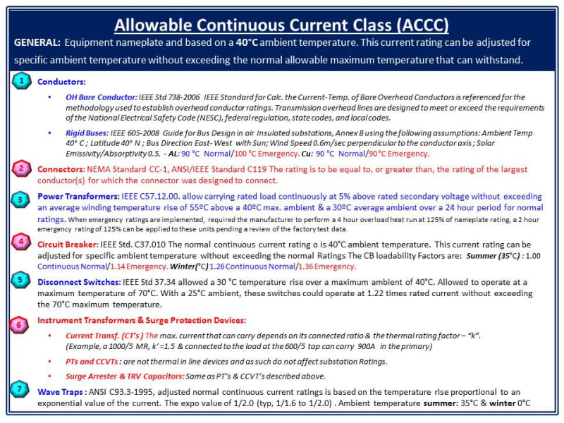

What about the bushing on isolators and SPS2 breakers?
For bushing on isolators and breakers the Allowable Continuous Current Class (ACCC) for connectors and bushings provided with the equipment follow the nameplate which is based on a 40°C ambient temperature. This current rating can be adjusted for specific ambient temperature without exceeding the normal allowable maximum temperature that can withstand.
Particularly the Siemens SPS2 dead-tank circuit breaker is normally rated for 55C ambient temperature that is above the 40C minimum required by the IEEE Standard.
I am not sure the ACSS or regular ACSR or rigid bus will be a better choice for jumpers and short connections inside the substation equipment.
Below is a general short guideline for the Allowable Continuous Current Class (ACCC) for equipment that will include bushing on isolators and breakers.

If the conductor temperature is higher than the standard continuous rating (normal & emergency), the equipment needs to be derated accordingly. A few options are available:
a) Oversize the equipment and work with the manufacturer to derate the continuous rating (I do not know any acceptable standard procedure to derate equipment bushing-connector assembly operating the jumpers at higher temperature).
b) Using hotter and smaller conductor could be a more expensive proposition than use a larger or multiple conductors per phase.
