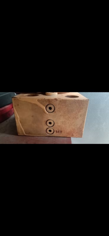

Sir,
We are using mainfold blocks in our application,we have some doughts please give suggestions sir.
Image attached below
1.why 4 no's ln key used in mainfold blocks, what is the use of that .
2.in some mainfold blocks named as 15x,14X . what is the meaning of 15X,14X ?
Please give any suggestions
Sorry for distrubence
Thanks & Regards
The larger of the 4 plugs is probably blocking an unused port. The other 3 would be plugs to close construction passages or possibly test port access.
