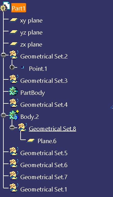

Hi All
I am new to CATScript and trying to learn from different forums in internet.
I request an help on the macro below:
Requirement is to create a plane parallel to selected reference plane and point.
Option 1:
My requirement is the new plane created must be created in exiting active GS.
Option 2:
Inform the user about the active GS or Body. Ask the user to selction whether the new plane to be created in existing active GS or to be created in a new GS.
MACRO what I crated is as below and the plane gets created always on the first GS even though the first GS is not active

Hi.
Use [tt]CATIA.ActiveDocument.Part.InWorkObject[/tt] to get active GS or Body.
Hi Cthulhu,
Thanks for your valuable input. It works.
I modified the code as below.

Set hybridShapeFactory1 = part1.HybridShapeFactory
'Set hybridBody1 = hybridBodies1.Item("Open_body.1")
'--With below line new Geometrical entity will be created in active GS
Set hybridBody1 = CATIA.ActiveDocument.Part.InWorkObject
Set hybridShapePlaneOffsetPt= hybridShapeFactory1.AddNewPlaneOffsetPt(reference1, reference2)
hybridBody1.AppendHybridShape hybridShapePlaneOffsetPt
part1.InWorkObject = hybridShapePlaneOffsetPt
part1.Update
