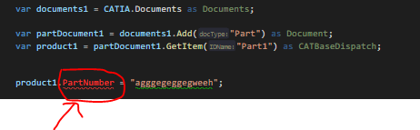

Hello everyone. Interested in creating a Part of the document and changing its name (c #, WinFrorms project, the name is taken from the textbox).

If you use it in C #, it doesn't see PartNumber method:
product1.PartNumber = "agggegeggegweeh"
C # code:
Code:
var documents1 = CATIA.Documents;
  var partDocument1 = documents1.Add ("Part");
  var product1 = partDocument1.GetItem ("Part1");
product1.[b]PartNumber[/b] = "agggegeggegweeh";
var doc = documents1.Add("Part") as MECMOD.PartDocument;
doc.Product.set_PartNumber("aggeggafdrtg");
This code works perfectly! Thank you!
