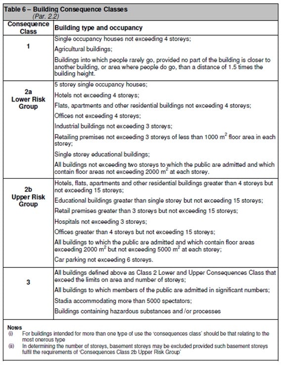

Also watch if the increase in height changes your consequence class/vertical tie requirements etc.
You’re probably ok though if it’s an RC frame anyway.
Any explanation would be appreciated.
This table of course differs depending on what part of the world you’re in. But adding a storey can change your consequence class, which can change your robustness tie requirements.
If you’re in a seismic zone then you may have further requirements to meet.
