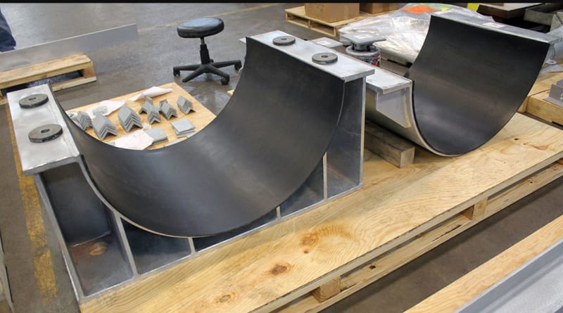

Good morning all. I'm working on the structural supports for an aerial crossing - sanitary sewer, ductile iron pipe. Typically these are set on concrete piers with a formed saddle and a strap holds it down. Due to a variety of site constraints, that's not an option. I originally detailed an integrally fabricated saddle for the pipes to sit in, but it's a sticking point on cost and I've been asked to reconsider this connection.
Anyone have any good resources for supports for DIP on a steel beam located outside? Most things I've found that are prefabbed are meant to sit up on pipe stanchions and are generally intended for interior use without the inconvenience of environmental loading.

Assuming you are looking for a steel support. Here are two companies in the pipe support field. Link and Link

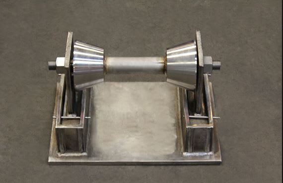

I would recommend galvanized support with a wear pad to protect the DIP and separate the dissimilar materials. Added photos for attention

I've been away from my desk all morning and, after a conversation with my client while I was out, we decided the best way forward is to design a custom fabrication (like the picture GC_Hopi has) but then provide minimum specs for alternatives if the contractor has a better idea. All galvanized with bearing pads and can be bolted down to the beam.
